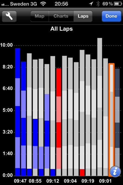

You have that already. :-)
You can see the virtual best by selecting any lap of your session, pressing Lap Time in the Results section and get a picture like the one attached. The blue bar in the right is the virtual best made up from best sector times (red).
