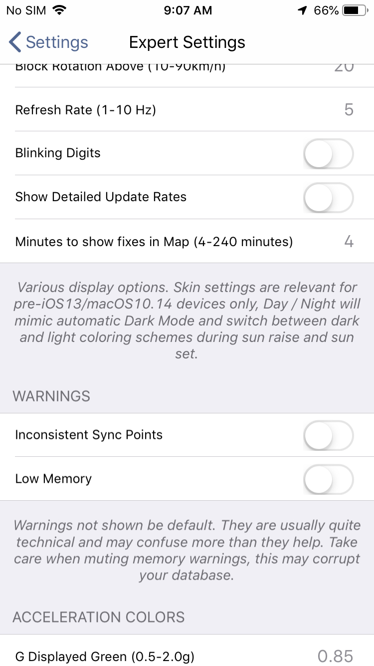

Harry wrote: Thu May 30, 2024 6:31 am There is a problem with reporting proper free memory values for older iOS versions. To work around, please disable the Low Memory warning in Administration / Settings / Expert Settings. The warning elements are way down on this screen.
I have already done that. (Screenshot attached). I think I had this problem before and so I already had this set up.

Hmm, can you please send a Contact Mail from LapTimer’s startup screen. Add a screenshot of the text Storage <0MB. It should at least change to a warning only once the Expert Setting is set.
While the red alert is disturbing and make you miss serious problems, it is really just a warning. LapTimer will work as usual, although it thinks it is low on memory.
