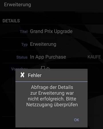

- cannot upgrade on the grand prix edition -> remains in petrolhead edition

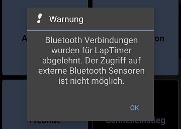

- cannot connect to any external bluetooth devices (GPS, OBD) [I tried the expert setting Force Insecure BT Connection]

I have not tested Android 13 yet. The reason for these messages are:
1) Add-ons: this means LapTimer can't access PlayStore with the ID configured currently. Please start PlayStore and make sure you are logged in.
2) Bluetooth: this means Android does not allow LapTimer to access Bluetooth. Please check permissions in Settings app.
Device is permanently connected (logged in) to the Play Store...
I tried also giving the HLT app all permissions. Doesn't work. There is no specific BT permission anyway.

Update: First issue with the Upgrade to GP version is solved. I opened explicitly the Play Store and then HLT got the connection

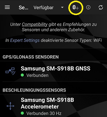

When I tap on "Add BT device" the app crashes:

This is to add paired BT SPP devices. The crash will be related to the problem with permissions. Should not happen, but probably a code path never used before 13...
Please send information on the BT LE device you tried to connect.

Yes I paired my two BT devices first and then I wanted to add them. Did work without any problem on my old Smartphone.
I use these two devices:
OBD -> OBDLink MX BT
GPS Logger -> Qstarz BT-Q1000eX (10Hz)
