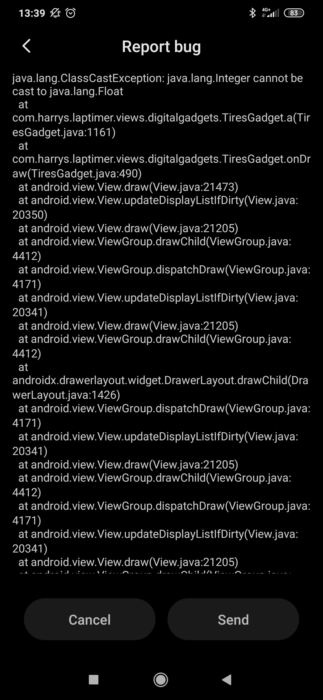

Tires tab showed up after restart of phone / HLT. However now I get Java errors trying to open tires page. :(
See attachment

Thanks, I will check and add a fix. The fix will get available as part of the *next v24 beta* update in case you want to get your hands on it fast. I think it will be in 2 or 3 days. See viewtopic.php?f=11&t=5737 for the details.

Am I right that this occurs when displaying the Tires View with a motorbike as current vehicle?

Yes, you are right. This is with only one sensor connected as well, a rear wheel sensor.

One sensor is no problem, but the motorbike layout failed for the last v23 release. The v24 beta versions of LapTimer has this fixed already.

I have updated to the V24 beta (Last updated july 9th) but i am still getting this bug.
As soon as i try to enter the tires page (without the sensor connected atm, as it is on my bike, and i am away for vacation), the app crashes and i get a notification regarding integer to float conversion fault. I have reported the issue through the android reporting system.

Ok, I will check.
Re: How to find tire temperature?
Rechecked. The fix is working, but I need to release a new beta version first. :-) The current beta is not yet on the latest state.
