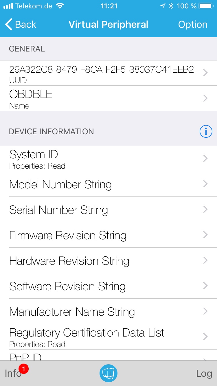

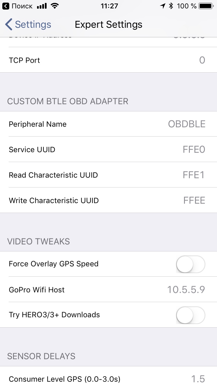

Thanks a lot for your reply. I totally understand that you cannot include all the possible BLEs into pre-configured setup.
I found another thread on this BLE where you already replied and I followed your instructions- viewtopic.php?f=6&t=4607
Managed to connect through LapTimer but no data is received but connection is green. I assume it is due to wrong read and write UUIDs but I cannot find them like in the thread above.
Thanks a lot for any advice!

Re: LeLink OBD2 BLE
You may try FFE1 for both the read and write characteristic. It may be a good idea to wait for next week - LapTimer v22 will get available. It has the BT LE significantly changed, this version definitively works with devices using the same GATT for read and write.
Re: LeLink OBD2 BLE
Thanks for advice! Managed to get connection with Service UUID of FFF0 and read/write FFF1 but no data. Laptimer shows connection and rate 70-80 Hz but no data at all. So I returned the device and bough compatible TONWON BLE. Now everything works.
