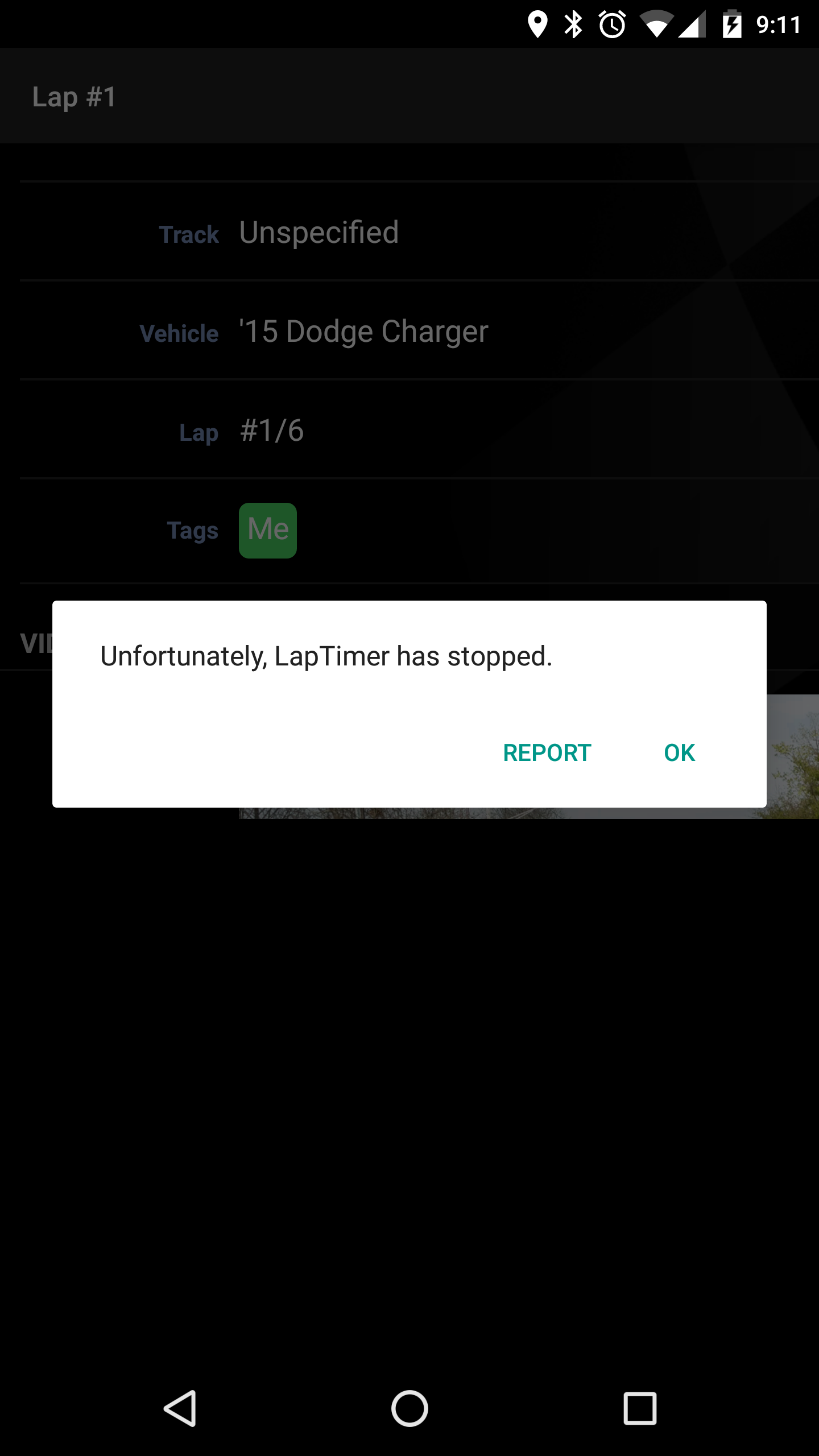

Now i encountered and issue when exporting the video's, once the video is at 100% the app crashes, and the video does not get saved. I verified I have enough space. This is quite strange, as it worked last night when I did a 4k Video, these ones I am trying were both 1080 and 720.

I assume you updated to LapTimer v20 the last night and use hardware accelerated overlaying instead of the old software based process now. I have received some crash logs and work on a solution. In case you want to work around this issue currently, force the use of the old process for now: LapTimer ‣ Administration ‣ Settings ‣ Expert Settings ‣ Video Tweaks ‣ Force Software Encoding.
