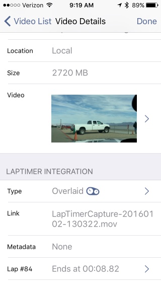

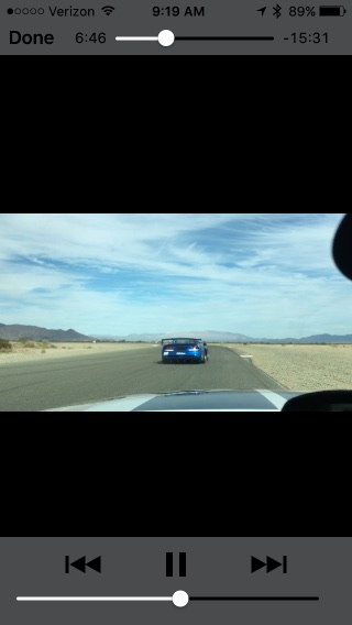

Hi Harry, The video was originated as RAW and then I set it to Overlay and nothing happened. There used to be an export or some sort of button to convert to overlay, but I see nothing there. There is no activity by HLT when I select Overlay. I thought by moving to cameral roll, it would automatically overlay the video, but it was the same non-overlay video. Attached are two screen grabs.

You switched the Video Type instead of running an overlay. You got an alert you ignored. ;-) Please goto Video Details and switch the type back to Raw. Next, goto the lap you want to overlay and press Overlay. This will create an overlaid video as expected. This is the way it always works, the type selection in Video Details is for troubleshooting only.
