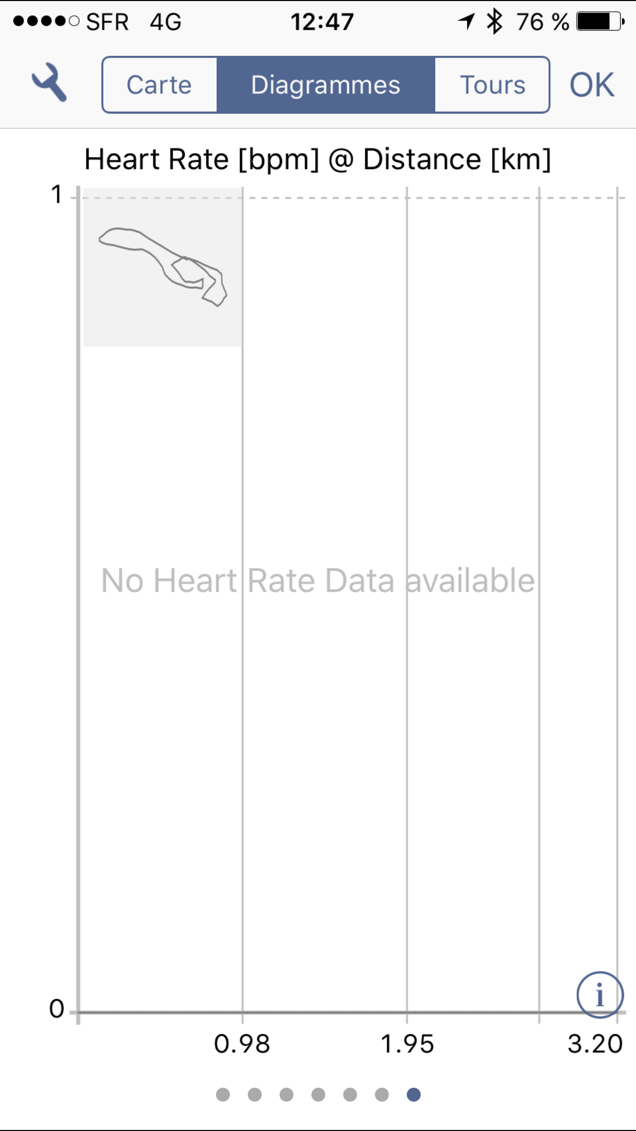

hello I can not get the heart rate watch with my apple in order to integrate the video
Re: Apple Watch
Please check:
1) Do you run LapTimer GrandPrix?
2) It is recommended to switch the Apple Watch to Workout mode while driving. Otherwise, the update rate of measurements is so low it hardly generates any reasonable data per lap. You can check the rate recorded in the Health Kit app. In case you do not get the heart rate gauge or the Heart Rate Chart (Data Recordings), please verify there is really data available in HK for the time range of the LapTimer recording. NB: LapTimer does not store any HK data locally, it requests data from HK when displays / overlays are requested.

good morning heart rate is recorded in The application iphone but in the analysis of time on the chart appears

Monika
Posts: 84
Re: Apple Watch
Post by Monika »
please check first check if within the health app -> Sources -> LapTimer is enabled for reading health data.
Second: Please double check if heart rate data exactly sits within the lap time.
If still not working, please send screenshots of each heart rate datapoint (detail view of each data point as we need the precise second) and the export (.hlptr) of the lap (only the relevant lap!) to tracks@gps-laptimer.de
- Monika
Harry's LapTimer Team

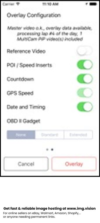

Harry wrote: Fri Apr 22, 2016 10:40 amLapTimer does not store any HK data locally, it requests data from HK when displays / overlays are requested.
Presuming the prerequisites are met (Laptimer enabled within Health app, workout recorded on Apple watch), the Heart Rate data should appear as available data during Overlay Configuration?
Just trying to understand as this feature is not documented within the Video Documentation PDF.
Thanks.
Re: Apple Watch
There is no configuration for Health overlays. In case you run GrandPrix (or upgraded Rookie / Petrolhead) and health data is available for the time range of a lap, heart beats are added automatically.
