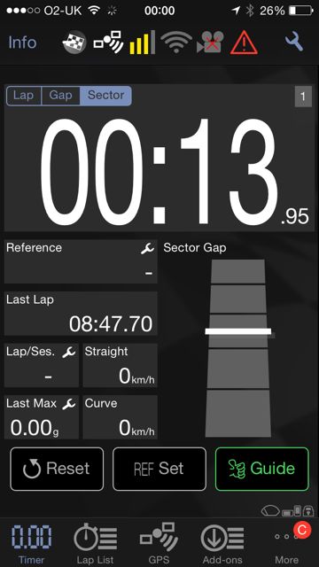

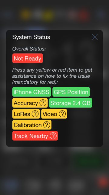

Just to be clear, I went to 'Guide' and 'Load Track' and loaded COTA details. I then push Start Driving. I go to the timer screen by pushing bottom left icon 0.00 Timer. At top of screen is a video camera with a Red X through it. I push that and get the System status screen open up. This shows video in yellow and says to go to video screen to turn it on. Screens attached.
Do I need to be at the track to activate video?
Is there a way to test it ahead of time?

You can't test using the COTA track set unless you're at COTA. It's easy, though, to create a basic track set on surface streets for testing purposes. Open the Guide wizard from the More menu, touch New Track and follow the instructions. Once you have a start/finish line defined, the Track Nearby bar should be green and you can drive a few laps at legal speeds and see the results.

The button for the video mode is only available / visible in landscape mode (because it makes no sense to video in portrait mode), once you're in the video mode you can choose between staying in the video view while on track or activating the video background recording, giving you the possibility to see the timer view while on track. At that point, the red cross on the camera should be gone.R8Maverick wrote:Harry,

That's the point. The Video button is a large blue one in the bottom of Timer View (just like Reset/Set/Guide in your screenshot). It becomes available in landscape and after the tab bar slides out. The later will be changed in the next major release - the moving tab bar is sometimes counter intuitive...

Thanks. I got it to work creating a local track. Do I need the Grand Prix edition to video on a Go Pro Hero and use the Go Pro video in place of iPhone video ?
