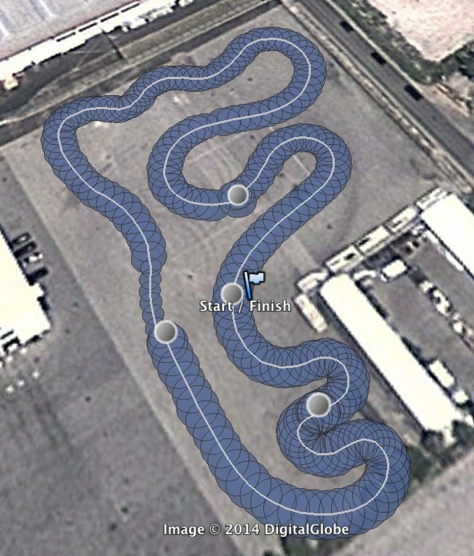

Re: Lap splitted in 4 parts?
Yes, at least pretty consistent 4 "laps" for each "real lap" :-) The snapshot shows the first 4 laps, for all other "real laps", it is the same picture. As the track is very tight, it is possible the split to the left is a false alarm from the Start / Finish Trigger, the other are not. To work around false alarms in the future, please consider adding a driving direction to triggers. For this example (track driven counter clockwise), the Start / Finish is passed driving Northwest. So adding a driving direction of e.g. 330 degree will work around the trigger firing on the counter straight.
But maybe this has not been the problem here. As all the laps show the same splits, the only explanation for me is there have been some additional triggers (e.g. from a former AX route). Please open the Lap List in LapTimer and check if you see conflict markers (red exclamation marks) for your tracks. These need to be removed as LapTimer will use any trigger it finds, not only those for the track selected.

Harry wrote:Yes, at least pretty consistent 4 "laps" for each "real lap" :-) The snapshot shows the first 4 laps, for all other "real laps", it is the same picture. As the track is very tight, it is possible the split to the left is a false alarm from the Start / Finish Trigger, the other are not. To work around false alarms in the future, please consider adding a driving direction to triggers. For this example (track driven counter clockwise), the Start / Finish is passed driving Northwest. So adding a driving direction of e.g. 330 degree will work around the trigger firing on the counter straight.
