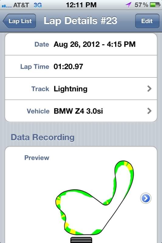

What do you see in the Lap's Details? Specifically Data Recording / Fixes?
Dubbedown
Posts: 173
Joined: Wed Jan 04, 2012 9:36 pm
Re: Problems with video overlays
Post by Dubbedown »
Harry, screenshots below, let me know if I should click on a specific field:
