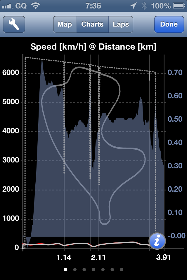

I'm also having the same problem with the BT1 ODB speed readout occasionally spiking up to 6000+ (it appears that it is confusing RPM value for speed?!) and I am using the Dual XGPS 150 as well.
It seems to be happening almost every lap, but not always. Is there anyway to prevent this from happening? I was looking at the expert settings relating to the ODB but am not sure if changing those values would help??
Oh, the vehicle is a 2009 BMW 135i. I know there have been issues with BMW ODB... Anyway, any ideas how to fix this? :)
ODB speed values corrupted
photo 1.PNG (121.09 KiB) Viewed 3403 times
ODB and XGPS 150 working properly...
photo 2.PNG (117.65 KiB) Viewed 3403 times
