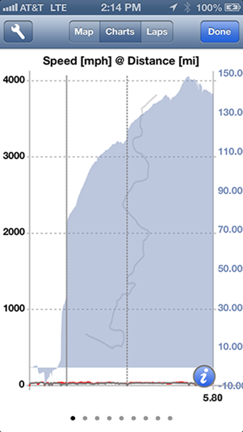

I think I had it showing speed differently at one time before. It now lists speeds of 4000 mph as the highest on the charts though it seems the speed readings are correct otherwise. : )
Re: Speed Chart within Lap Details
I'd assume there is a wrong value somewhere in either the lap's or the reference lap's speed. Please try two things: turn off the reference lap (press button in the top left). Double tap the chart to reset the zoom. If both do not help, please export the lap displayed to .hlptrl and send it to me for testing. Thanks!

Tried those steps with no luck. However, after looking it over I think it might have something to do with my XGPS150A. Those are the only laps which show 4000 mph on the y-axis of the Speed chart. The other laps using internal iPhone 5 GPS all look good. Please know that I did update the firmware for the XGPS150A.

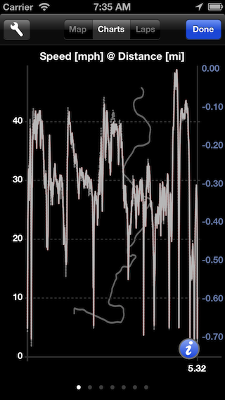

I found one ugly OBD speed sample (6552.2 km/h) which scales the diagram as shown above.

Removing this single fix results in what you expected:
iOS Simulator Screen shot 16.05.2013 07.35.15.png (49 KiB) Viewed 5738 times
iOS Simulator Screen shot 16.05.2013 07.35.01.png (119.11 KiB) Viewed 5738 times
