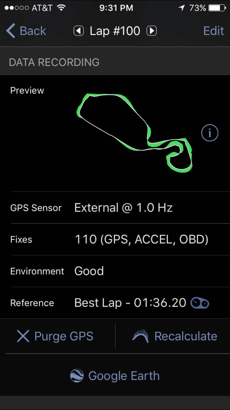

Hi, I'm using an XGPS160 with my iPhone 6S running iOS 9.3.1 and HLT v20.
I have found that my session data sometimes ends up being 1 Hz instead of 10 Hz. Nothing changes in setup -- the phone is hardwired, the GPS battery is charged. This can happen at the same track on the same day. Three out of four session might be 10 Hz and one of the four will end up being 1 Hz. It's kind of frustrating since everything shows up as green/ready when I'm in the pits.
Is there something I'm doing wrong and is there something I can check in the pits before heading out on track to verify that I'm going to get 10 Hz sampling?

Seems that's not the case with my issue. The lap analysis shows external GPS source.
Any ideas?

Hi Harry. Same problem today. One session got 10hx z and the second session captured at 1hz. Both show external GPS and both had the phone in airplane mode with only Bluetooth enabled.
Any ideas?
