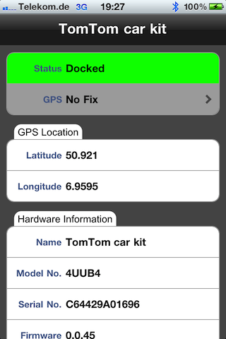

Re: TomTom Carkit with iPhone 3GS & iPhone 4
Please install the 'Car kit tool' from TomTom available in the AppStore for free. You can use this to analyze the basic connection.
Looking into the chat, I doubt they gave all hints one can give on making this work.

I have the tomtom car kit tool installed on the iPhone 4 and when I open the tomtom car kit tool app with the phone in the carkit I get 'not docked' and GPS: no fix.
I believe this is standard because the app does not support the latest iOS.
Hi again,
As stated above, TomTom support sent you the wrong direction. The car kit definitively connects to the iPhone4 with iOS4.3.2 installed. I just went out to my car and checked again (no signal because the car stand in a parking lot, but docked):
I'd suggest to check the iPhone4 adapter again. It is well possible that the power supply pins have contact, but others don't. I had similar situations when I'd experimented with a home made adapter. By the way, the BT connection is not used by LapTimer (or the TomTom car kit app), both use the wired connection. BT is used for the audio features only.
Thanks Harry, I'll see what I can do.
btw do you still get 'this accessory is not optimised for this iPhone' when putting the phone into the carkit?
