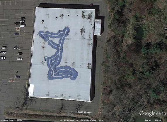

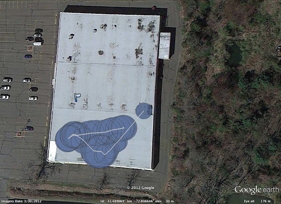

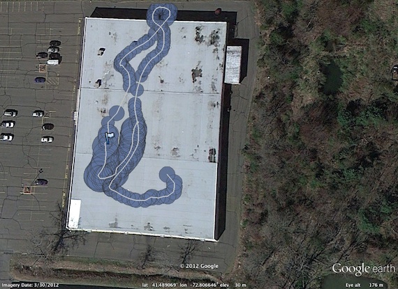

Please have a look into the snapshots attached below. That's actually what LapTimer 'sees' and needs to interpret... The blue bubble denote the area of confidence the GPS delivers. I believe the area is still too small as I can hardly recognize a track shape. I doubt it will be possible to get good enough positions within the hall as GPS receivers require a 'free view to the sky' to work effectively.
Sorry to say, but this 'in hall' driving will most probably not work with a GPS based tool.
