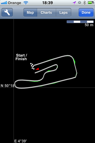

Last year I used the certified Mettet track - and had problems where it would not register the complete lap. I tried setting the detection to narrow but I did not get better results. I have not been to the track since then - but I hope to do further testing. The only option i see is moving the trigger to a spot where another part of the track is not too close to interfere.
Which leads me to the simple question - laptimer could use a better algorithm to detect the trigger based on:
-feasable laptimes
-direction of travel
-speed
attached is a lap that the start was triggered on the short straight
-wrong direction
-too slow
-overall laptime not possible (at least not for me)
This is an example of how a lap looks:
I hope my comments help in improving the app
