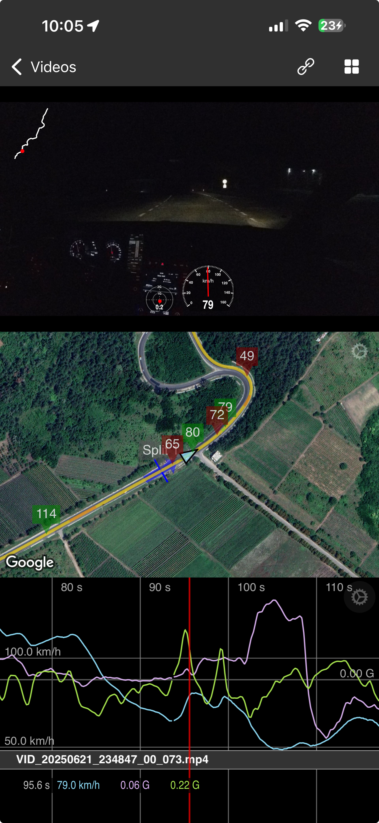

4) Have you considered changing the sync method for an external video with the gps/laptimer data?
I think racechrono approach of having a split screen with the video and map makes it so much easier, compared to setting the 'end' of the lap. I understand this might be easy when you are on a track and you clearly see the finish line in your video, but it's not always the case.
I'm attaching a screenshot and hopefully we can have this thing improved.
