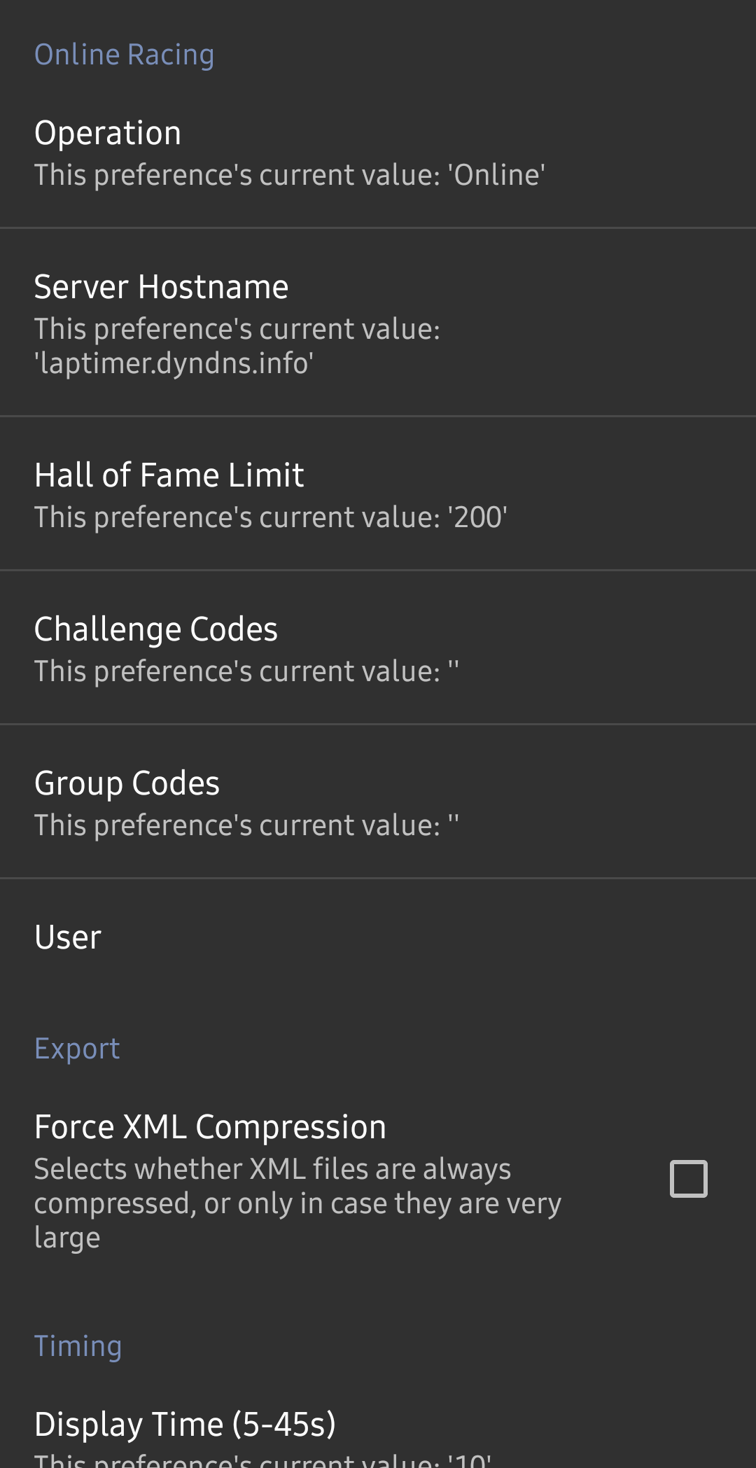

The modal that pops up on tapping the backup button informs me that there's the option to add my email address in expert settings. However I've looked up and down this page a few times and haven't seen any configs related to email addresses and backups.

When running an external backup, LapTimer will generate an email and present it using your favorite email app. In case you have configured an email address in LapTimer ‣ Administration ‣ Settings ‣ Expert Settings / Online Racing / User (agreed, it is hard to find), the address will be added to the email for convenience. Otherwise, you can enter it in the mail app yourself.

I don't the the email config option on the expert settings page either:

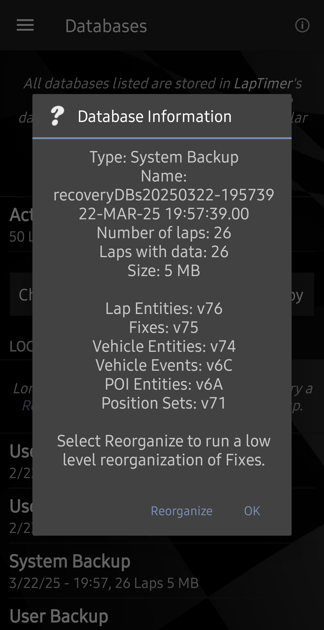

How big is your database, i.e. how many laps do you have in Lap List and what is the typical GPS rate you have? The GPS rate is usually 1 Hz in case you use the internal GPS but can be up to 50 Hz… It is possible the backup is created but cannot be added due to its size…

It's 26 laps, 5MB so < the 25MB max attachment size in Gmail.
Re: Database Backup not working
It is getting exported from a binary format to ASCII and is compressed afterwards. So a sizing from the 5 MB isn't possible. However, 26 laps are far from any limit and will not be the issue here.
