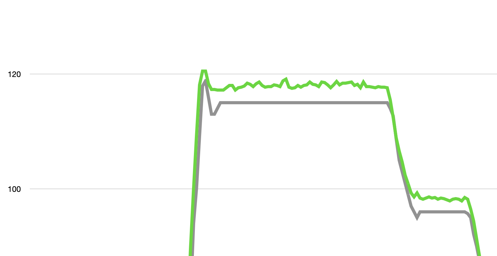

Ok, taking a deeper look at the data, SPEED_KPH column actually seems to be correct,
but WHEEL_SPEED_KPH apparently is reporting lower than set in the instrument cluster.
Speed was locked in to 120 km/h here.
Probably due to apparently wrong data entered in gear ratio?
Will try to run calibration.
I guess it is a wrong assumption, "WHEEL SPEED" would report what the dashboard is saying.

When you lock your speed to 120, the speed will be controlled to match the dashboard speed. The dashboard speed however, is not the real speed. And as written above, it isn‘t the wheel speed measured either.
