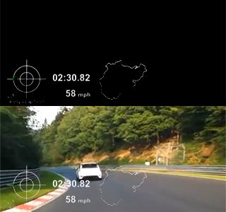

The solution is very simple. Only create the video with the display info (like before, but all colors pure white), but without the video layer. Use simple black background. That it is.
The user can use this video in a video editing software and as a layer 'over' a other video (e.g. a separate video from a GoPro Hero). The overlay is to configure in video software to "negative multiply".
I create a picture to illustrate. Upper the possible video from Harrys Laptimer and below the video from external camera with laptimer-overlay.

Yes, understood. Problem is this generates overlays without transparency - which should be the goal of any extension added. For solid colors, it can be done like you proposed.
