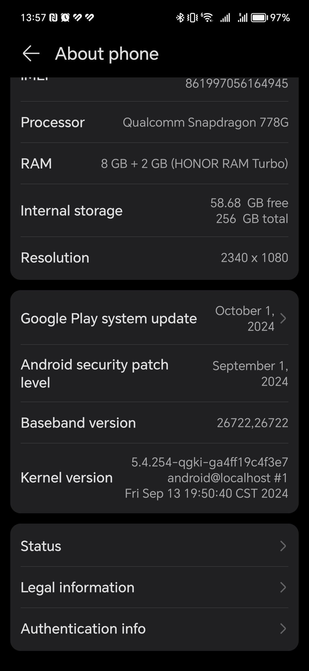

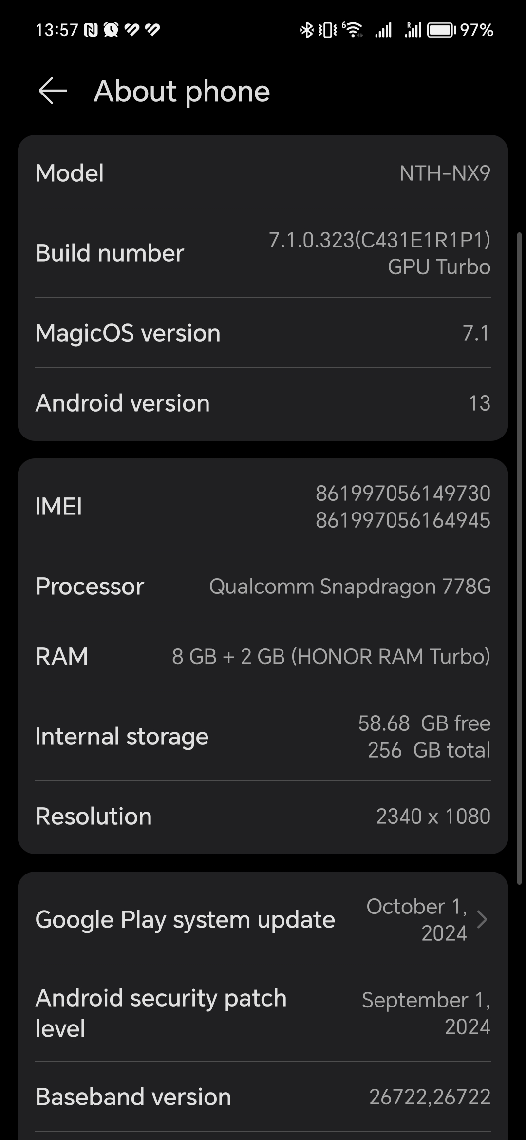

Posted: Fri Nov 08, 2024 2:29 pm
by Samuell32
No problem :) Let's finish this, I will try to describe all you need:
1. I did some racing on Nürburgring and Hockenheim ring. I have done videos as well and would like to download the video from smarthome and use it as a front camera for my YT channel -> when I connect smartphone to a PC, I do not see the videos
2. I would like to overlap lap timer with the video from Gopro 11 black -> the same problem, I cannot add any video from Gopro because I do not see them in lap timer
Complete system config here:
Smartphone:
PC:
Windows 10
If you need something else, please specify it and I will provide. Thank you.
