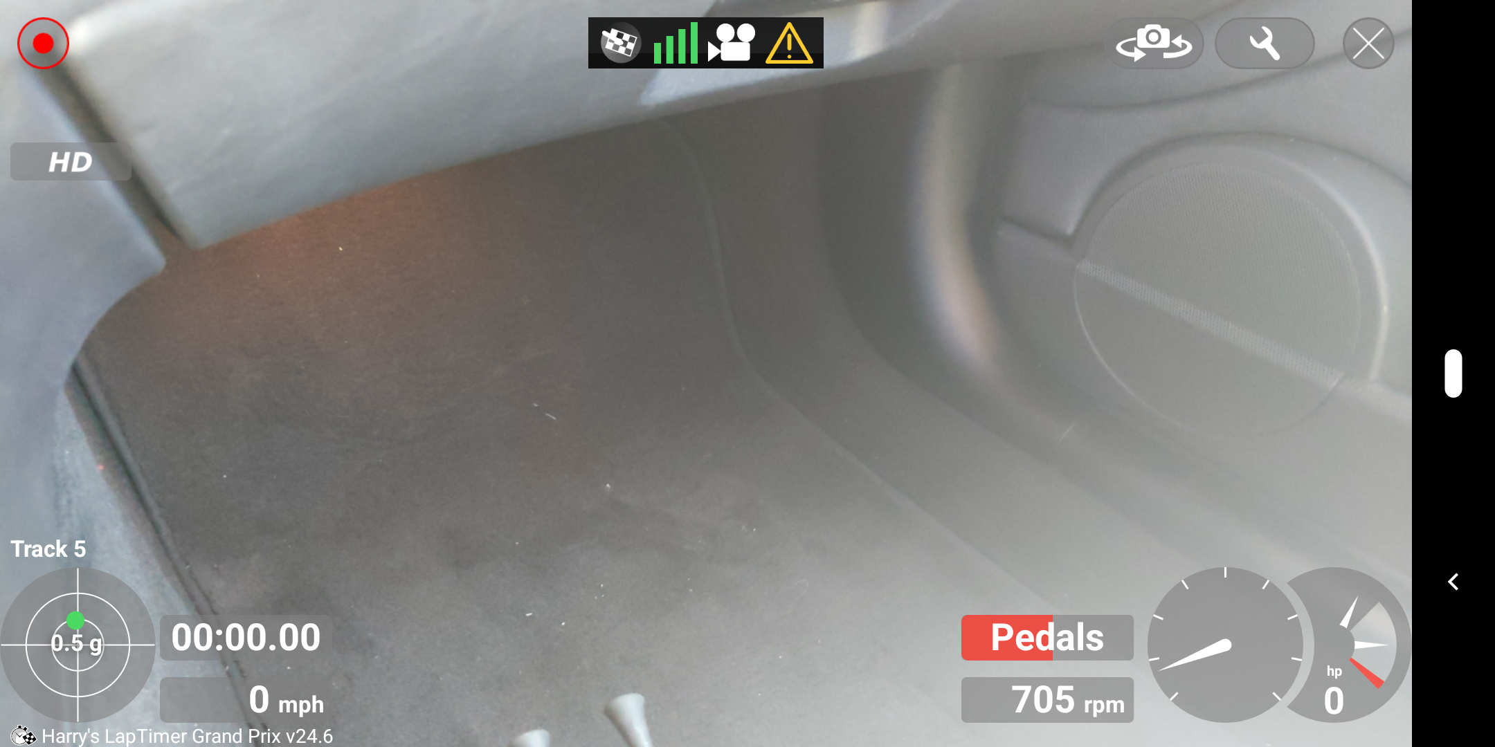

Ok just plugged in the OBDLink MX+ along with Grand Prix edition.
The HP/Fuel/temp gauges now show up but wondering why the gauge displays have no numbers and other stuff?
The update rate still looks like I need to tweak it
Re: OBDLink LX not connecting?
The sector colors will appear once you have entered your vehicle’s details like max torque rpm, max power rpm, max rpm.
Please keep in mind that displays may be incomplete or wrong as long as the OBD connection isn’t stable. Please concentrate on this for now.

The gears now show up, BUT the Fuel and Temp are still not appearing in the gauge. I've filled gas tank capacity within the vehicle details. Not sure where I need to fill out the temperature information for that to appear?
I was able to get the ODB connection to go green with the adaptive setting to optimized once I drove around
Great. Please select the LX sensor in Sensor List and display Sensor Information. This will give you a list of OBD parameters pulled currently. Post a screen-shot here. Fuel level is not propagated by many OBD gateways, but one of coolant or oil temperature should be available almost always.
