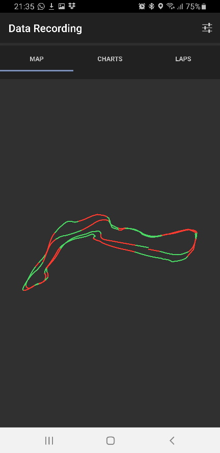

I want to ask. Today we were on track and strange thing happened. We did physicaly 10 full laps, but in Laptimer, there is only 9 and 2 are merged into "one". This happened after 2 laps (1,2 are ok, 3,4 are merged and 5-10 are OK again) How is it possible? Can I somehow separate them? It never happened before

Hello Harry,
- Screenshot_20220511-213535_LapTimer.jpg (37 KiB) Viewed 3954 times

Re: Two laps in one
This means the s/f trigger has been missed for one lap. This typically occurs when GPS accuracy is too low / disturbed. You can split this “multi-lap” as follows: select it from Lap List, follow Data Recordings / Fixes, select Verify Lap from the pop up list shown for the second icon in the bottom.
Select “Wide” when asked and agree to purge the multi-lap once it has been split. In case it isn’t split, enlarge the Wide corridor in Expert Settings and try again.
