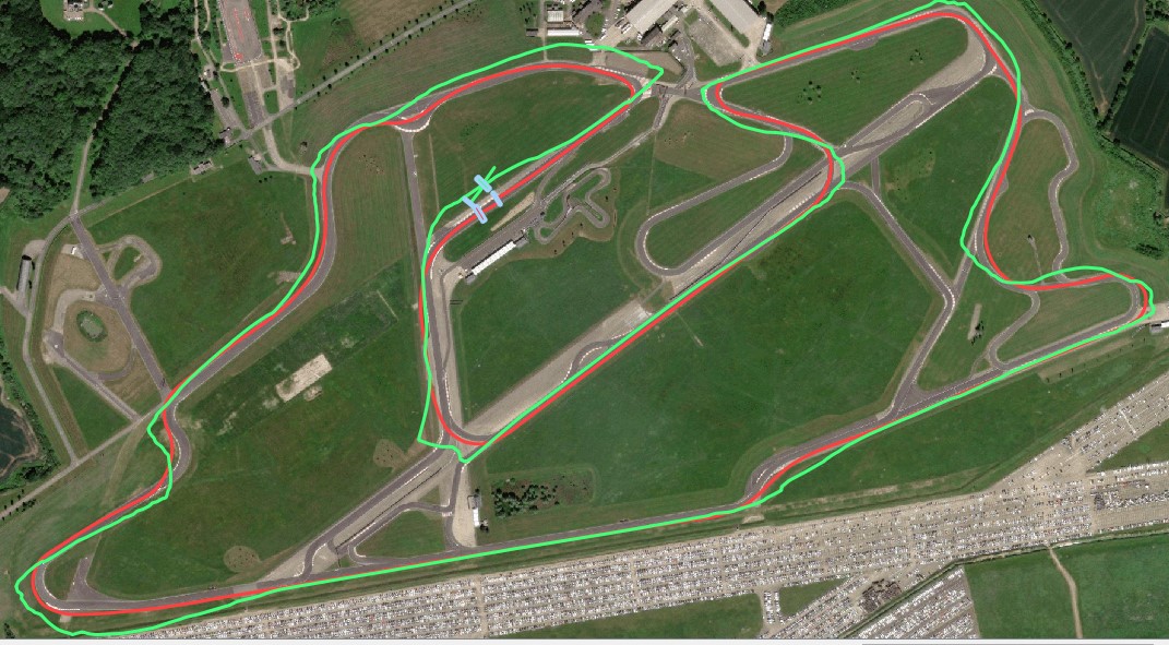

I'm also looking for a new GPS. I have used the Dual 160 (battery won't charge after a few uses, after about a year it just stopped working even when plugged in) and the Bad Elf (lightning connector) which is totally inaccurate.
See attached image: the smooth red line is a lap recorded by the Dual 160, the green line is a lap on the same track recorded using the Bad Elf.
bad elf.jpg (210.91 KiB) Viewed 56126 times
So I can't help except to steer you away from those two. Hopefully somebody will chime in with something they're happy with.

For a consumer level device, the red line is actually pretty amazing. I use my 160 for more than five years already, and it always worked fine. Looking into the BadElf plot - it is bad. However, it is probably worth checking the mounting position of your smartphone. The Lightning version does not over the flexibility of a BT connection, so one is more limited in placing it in a good position. But maybe you can move the smartphone further to the windscreen / front to make get better accuracy. Chip-wise, both should not be too different.

I was always very happy with the 160's performance, but it won't stay on for more than a few seconds now even when it's plugged in.
The 160 worked perfectly in the glove box, in the centre console, and in the passenger footwell. The BadElf is plugged into my phone on the dashboard. I don't think that can be a worse position but in any case I can't really move it.

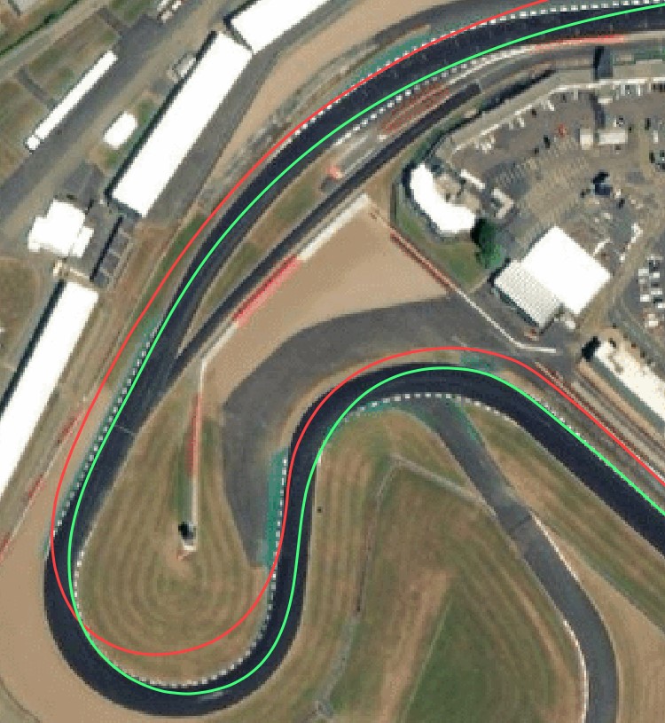

Two thumbs up for the Vbox sport. It worked flawlessly, no connection issues, and the battery lasted all day.
It's worth bearing in mind that at this early stage I would have spoken in glowing terms about the Dual 160 since it took a while for the reliability issues to emerge.
Attached is a screenshot of tracks on a corner of Silverstone: red line is from the Dual 160 in February, the green line is from the Vbox yesterday. This might be luck/favourable atmospheric conditions but the Vbox seems to be more accurate.

The effect you see is the so called GPS drift:
GPS drift is most often caused by reflections or shadowing on an image. It can also be due to atmospheric conditions which alter throughout the day, being most pronounced in the early morning or late afternoon. Due to the sun’s low angle relative to the atmosphere, there is more atmospheric interference.
It changes slowly and produces a - for a lap almost constant - offset. Direction plus distance. In case you are lucky, it is small. Only GPSes using ground based augmentation systems (GBAS) are able to compensate this. This works by sampling positions for a well known position near the track. The difference is what needs to be compensated. Neither the 160 nor the VBOX are in this league. So it happens.
Actually both of your recordings are great in terms of relative position.
LapTimer has an experimental feature that snaps a lap's recording to the track definition. You can try it: make sure the track set is loaded; select the (red) lap in Lap List; follow Data Recordings / Fixes and tap the second icon in the bottom. Select "Remove GPS Drift". This will analyze what drift produces the best match between line recorded and POIs defined. It will compensate that drift.
