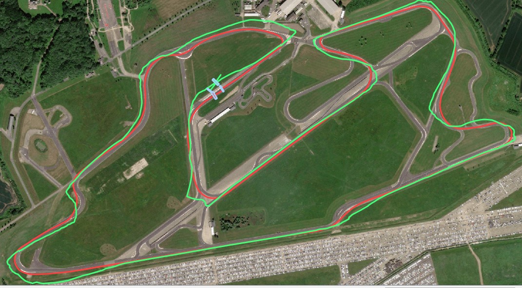

I'm also looking for a new GPS. I have used the Dual 160 (battery won't charge after a few uses, after about a year it just stopped working even when plugged in) and the Bad Elf (lightning connector) which is totally inaccurate.
See attached image: the smooth red line is a lap recorded by the Dual 160, the green line is a lap on the same track recorded using the Bad Elf.
bad elf.jpg (210.91 KiB) Viewed 56256 times
So I can't help except to steer you away from those two. Hopefully somebody will chime in with something they're happy with.

For a consumer level device, the red line is actually pretty amazing. I use my 160 for more than five years already, and it always worked fine. Looking into the BadElf plot - it is bad. However, it is probably worth checking the mounting position of your smartphone. The Lightning version does not over the flexibility of a BT connection, so one is more limited in placing it in a good position. But maybe you can move the smartphone further to the windscreen / front to make get better accuracy. Chip-wise, both should not be too different.

I was always very happy with the 160's performance, but it won't stay on for more than a few seconds now even when it's plugged in.
The 160 worked perfectly in the glove box, in the centre console, and in the passenger footwell. The BadElf is plugged into my phone on the dashboard. I don't think that can be a worse position but in any case I can't really move it.
