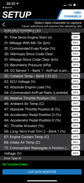

I have done a bunch of reading and looking into this, HLT does not show the IAT and ECT on my Civic FK8, I have been on the Civicx forum and confirmed that they are both standard supported PIDs @ this link https://www.civicx.com/forum/threads/su ... ids.27069/
This is the list of PIDs i see on GPS Buddy, I have also created a log file and sent it through
I have also used a different app that clearly shows data being recorded under the correct PID so i know that its sending data.
I have tried adding a custom PID in the expert settings but as you say in a different forum no point in doing that if its already the standard value
the PIDs are from wiki
67 103 3 Engine coolant temperature °C
68 104 7 Intake air temperature sensor
Any help would be awesome.

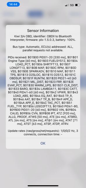

Just went and checked and still not showing anything up, also when I select the sensor it does not show the PIDs that I have defined. Does it matter that it has PID 60 showing and nothing after?
Re: IAT/ECT with standard PIDs on FK8 Civic not displaying
It is expected behavior that mode 1 and 9 custom PIDs are not shown in Sensor Information. In case your custom PIDs do not work, you need to send a log please.
