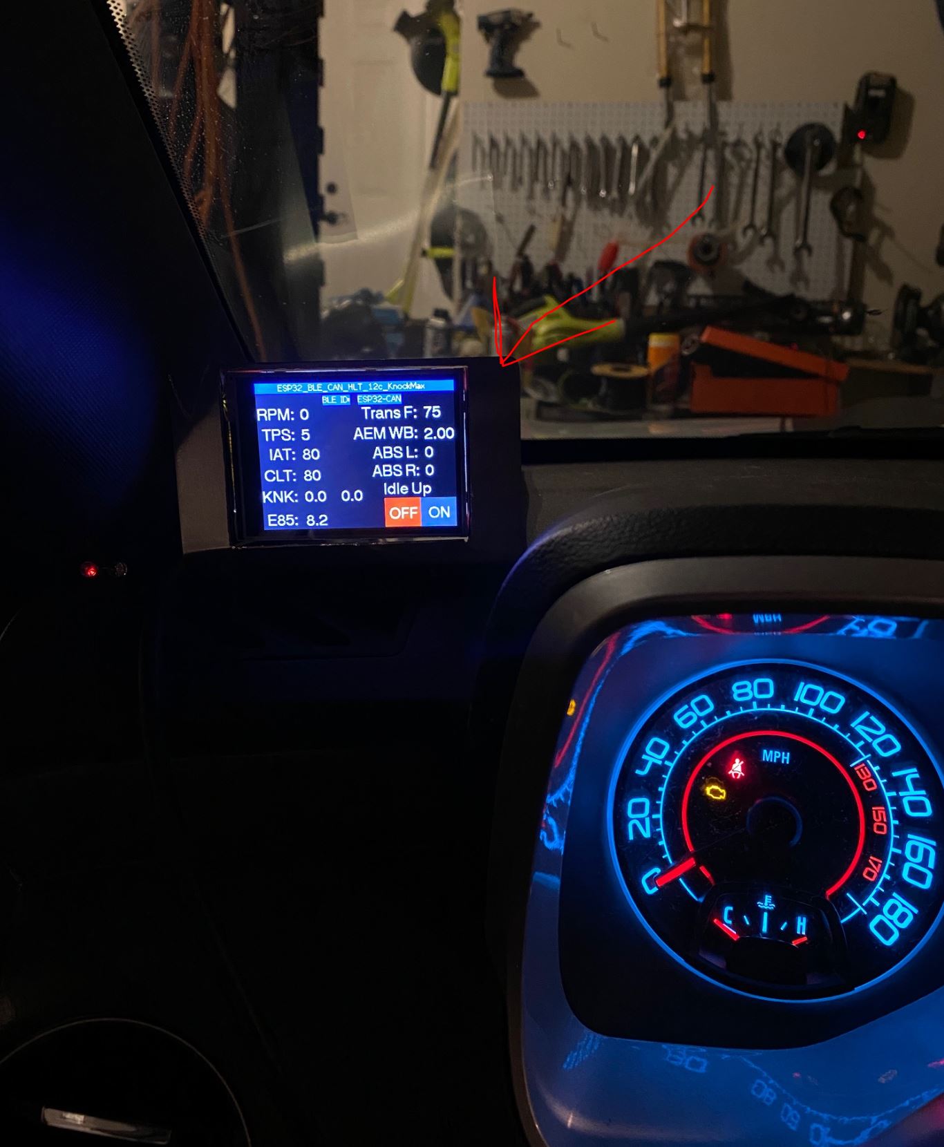

I have since added a 2.8" TFT display for the engine data, this is more advanced, but simply added to the existing code supplied by Renato, his code did not have to be modified in any way for the TFT to work. It shows special GM mode 22, things like Spark Knock, EGO/WBO2, high res ABS wheel speed, etc. Also includes a Knock Alarm, Knock History (currently holds max knock for 10s after peak value) and includes AEM X-Series EGO data, etc. With all of this, data is still sending to HLT at 20hz. Nice job Renato! Very efficient and compatible code that works with even the TFT add on. There's a lot going on with the CANbus code, and it works perfectly. There is nothing on the market that can display custom CAN/OBD data on your dash, while sending that same data to HLT, all of this from one device. It just doesn't exist.

Picture of the TFT display, below... it updates at about 10hz, data comes in at about 20hz, all of those channels at once - also much better than any of the big name OBD data display companies! I have that triggering an Alarm beyond 2.0deg Knock Retard, and holds the peak knock value for 10seconds so you can see it safely, after your off the throttle. Ethanol percent, pretty much anything you can think of can be added. I have it using a touch button to set idle to 1200rpm for times when you dont want to sit idling for long, like warmup or track staging lanes, idling is generally bad for a modified engines. I had it setup to turn on cooling fans, still plan to include that as a second touch button, but removed for now.
