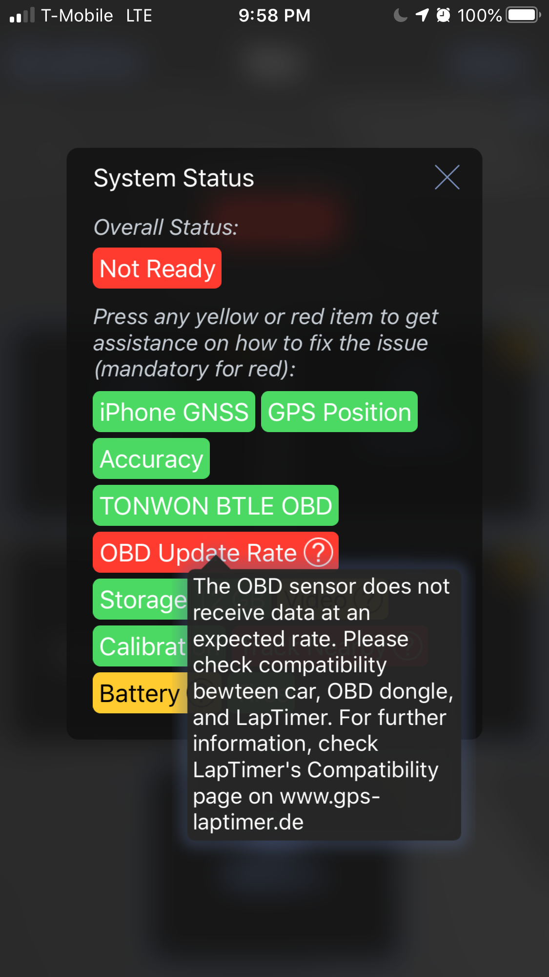

When I run Lap Timer, I get the following Not Ready error:

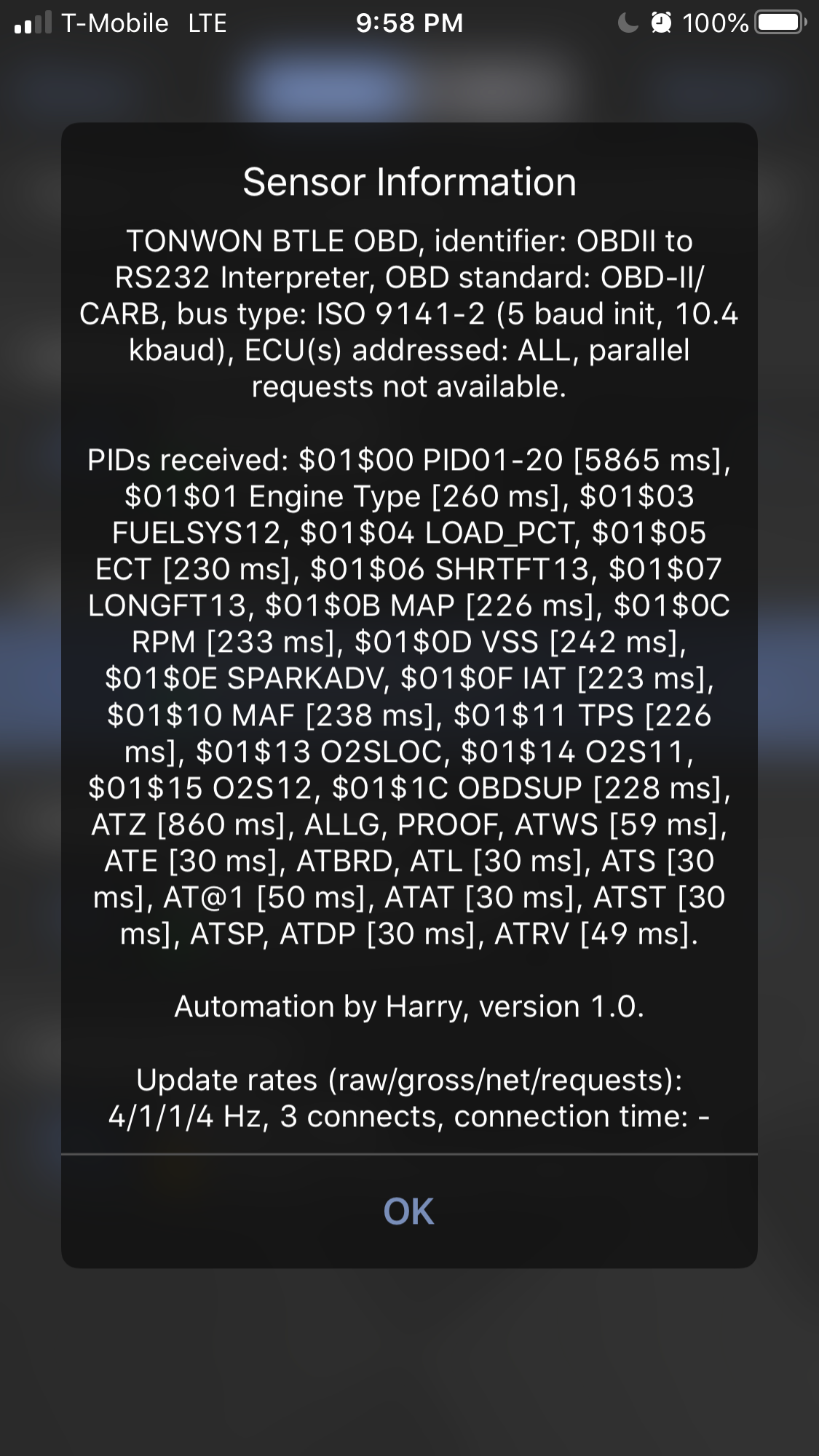

When I look at the sensor information I see the following:
Any suggestions?

That's a pre-CAN car. Update rates will be around 2 Hz for these usually (which is not a lot). At least when creating the above snapshot, the rate for your car / adapter combo even fell below to 1 Hz. Once a connection is going below 1 Hz, LapTimer issues the OBD Update Rate warning. Provided your rate stays between 1 and 2 Hz (after rounding), that's probably what is possible and you can ignore the warning. You can try to limit ECU access to ECM/PCM - you can find an Expert Setting in section OBD Tweaks to focus any bus request to one ECU. This sometimes improves the rate a bit. In case you do not get data at all after changing the setting, try TCM or return to ALL. More information on this can be found in Engine documentation available at http://www.gps-laptimer.de/documentation.
In case the rate is falling to zero or the sensor even disconnects from time to time, there is a general issue. Try the hints in viewtopic.php?f=39&t=1500 for this.
