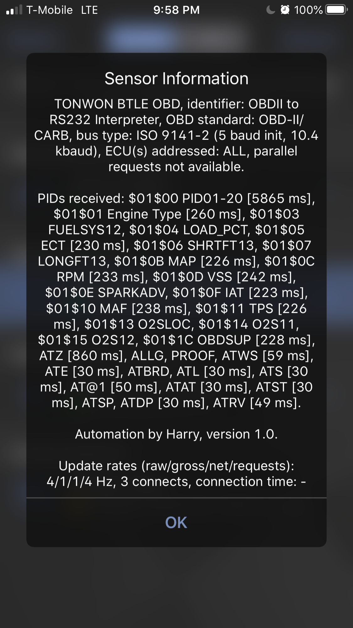

When I run Lap Timer, I get the following Not Ready error:
When I look at the sensor information I see the following:
Any suggestions?
Thanks in advance.
Larry O'Keefe
Washington, USA
Re: OBD Update Rate error - TONWON icar PRO BLE 4.o and 2998 Nissan 200SX SE-R
That's a pre-CAN car. Update rates will be around 2 Hz for these usually (which is not a lot). At least when creating the above snapshot, the rate for your car / adapter combo even fell below to 1 Hz. Once a connection is going below 1 Hz, LapTimer issues the OBD Update Rate warning. Provided your rate stays between 1 and 2 Hz (after rounding), that's probably what is possible and you can ignore the warning. You can try to limit ECU access to ECM/PCM - you can find an Expert Setting in section OBD Tweaks to focus any bus request to one ECU. This sometimes improves the rate a bit. In case you do not get data at all after changing the setting, try TCM or return to ALL. More information on this can be found in Engine documentation available at http://www.gps-laptimer.de/documentation.
