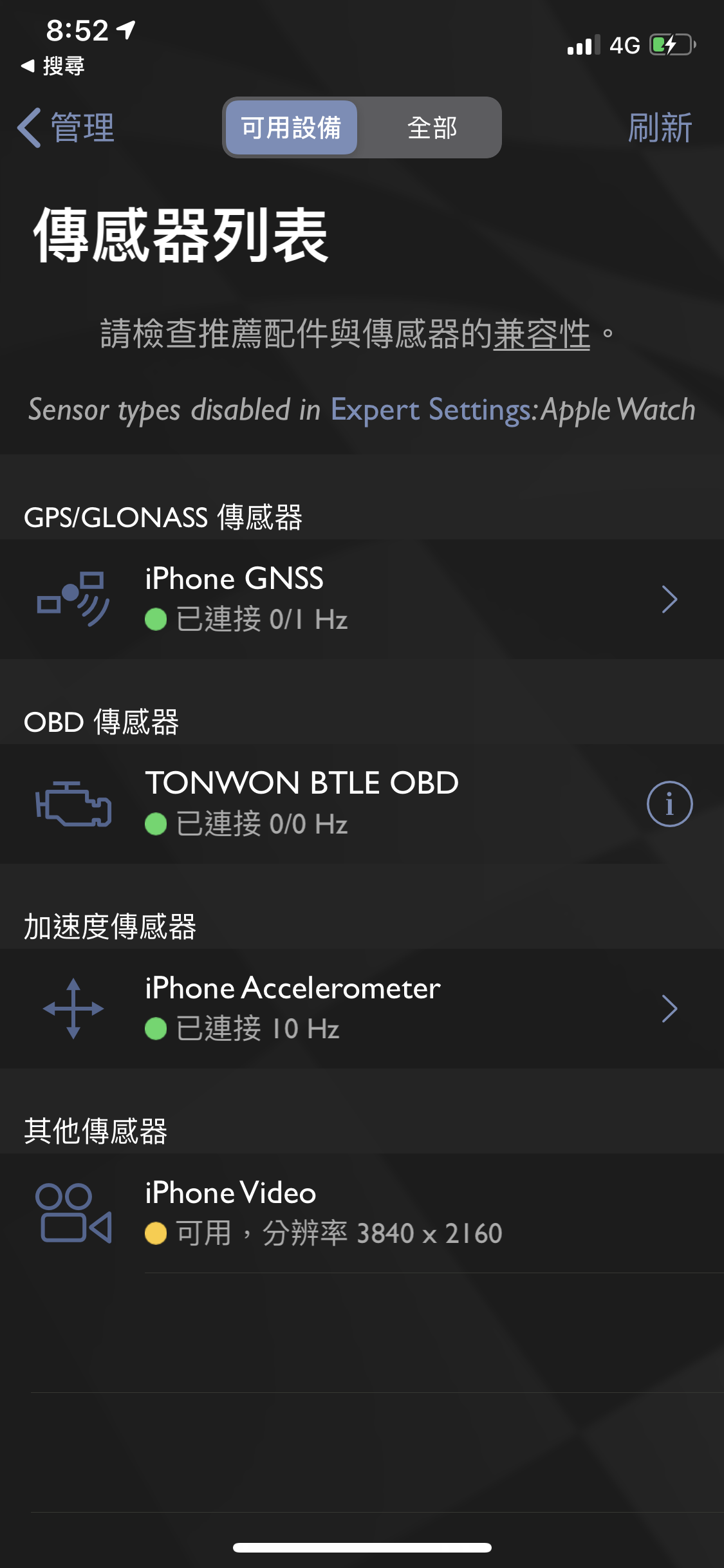

Does anyone use Harry's laptimer with your Supra yet? May I know which OBD2 that you are using have a decent OBD2 rates for Harry's? The Tonwon BLTE works well for my Porsche 981 and Mazda. But when attach it to Supra, the update rate is pretty low even stick to 0. I wonder which BLTE OBD2 works. Thanks

Please have a look into viewtopic.php?f=39&t=1500.
This looks like some compatibility problem. I'd start with disabling parallel requests.
Re: Supra OBD2(Tonwon BLTE) with Harry's laptimer not working well
No luck with disable parallel requests. Also I reset the settings to default. The result remain the same.

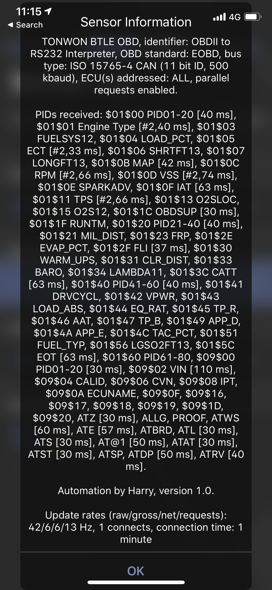

I can get 14Hz by reset the expert setting and use TCM. I can GET 14/4 Hz update from OBD2 now.
But the overlay engine RPM displays is not smooth as I had with another car. Any suggestion?

Can you send a snapshot of Sensor Information like you did in a former post?

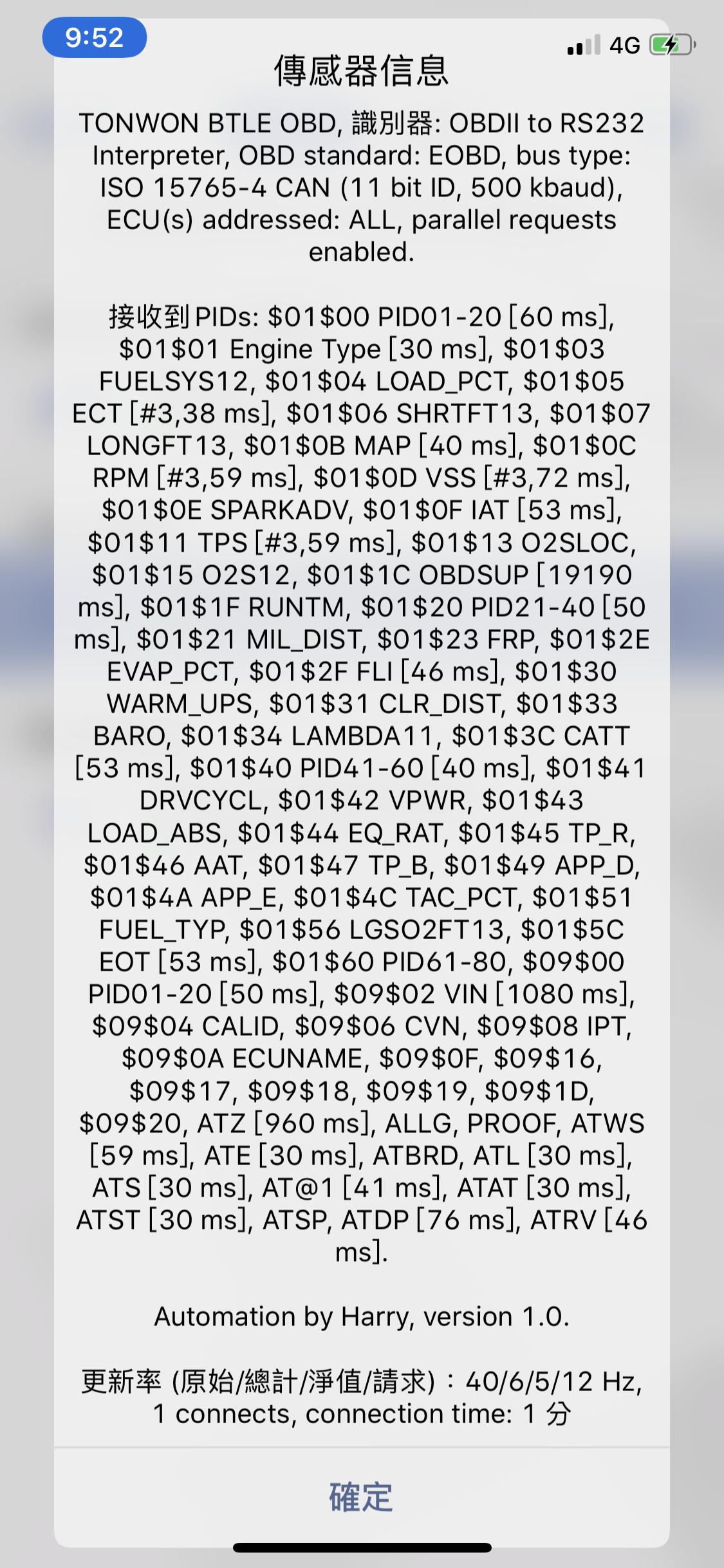

I switch back from TCM to ALL. Here's the current update rate. I'm curious the meaning of the rate.
What does 40/6/5/12means?
Is 12 the request rate by laptimer? And 6 is the actual response rate from the OBD2.

40 (raw) means 40 PIDs per second received
6 (gross) means 6 full sets of PIDs per second received
5 (net) means 5 full distinct sets of PIDs per second received
12 (request) means LapTimer issues 12 ELM327 requests per second
Gross and net will be the same for most sensors, ELM327 based OBD sensors in particular.
LapTimer groups individual PIDs to PID sets (made up from rpm, wheel speed, map, maf etc) and aligns them with GPS.

Nice explanation. I understand it a bit more now. It sounds like the more requests be issued by Laptimer the better.

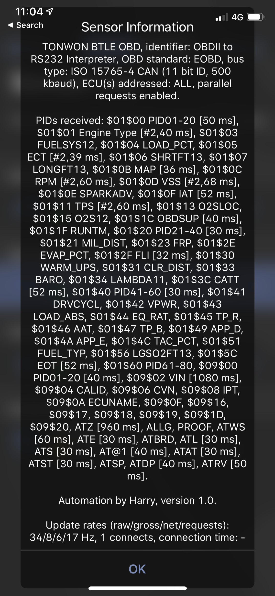

I attached three different settings. I do really want to make the overlay smoothly for the speed and engine RPM.
Also sent the GPS/OBD buddy verbose debug log to you. In case of ALL, would it be better to exclude some PIDs those Laptimer doesn't use? I assume the PID looks like $01$0F IAT . Can such PID be excluded to help? Any document of how to exclude PID?
From the attached ALL-aggresively setting, the row was 35 and Laptimer issued 17 reqs/sec. Does it mean the ALL-aggresively the best option for GR Supra + Tonwon OBD2 combination?
