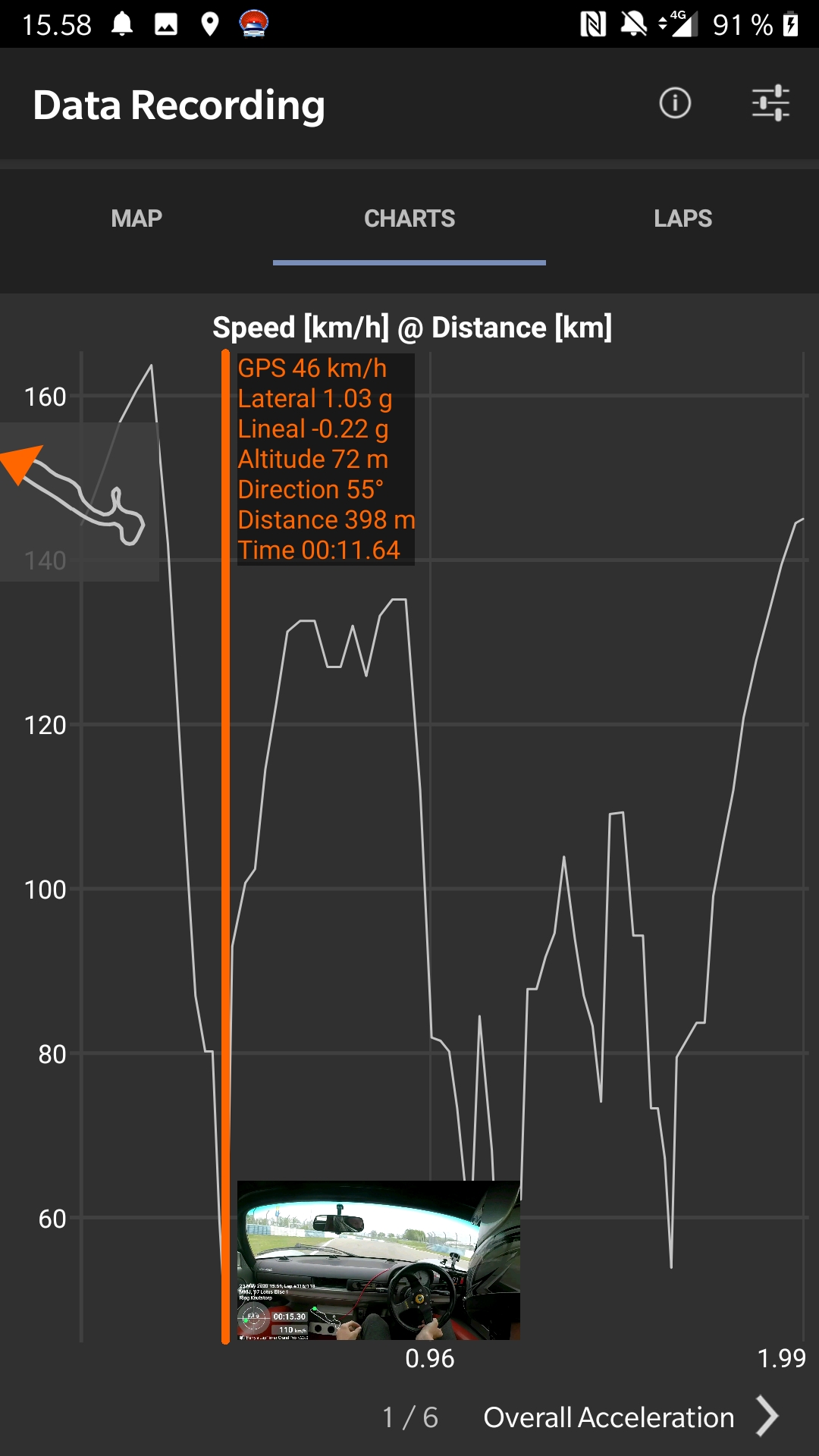

To me it looks like the position is in sync while speed is *late*. The reason might be that speed is heavily smoothed by your OnePlus, thus adding the lag in display. To find out, please select the lap from Lap List and follow Data Recordings ‣ Preview. Switch to the Charts tab. You will see the speed diagram now and can check speed development:
Provided you have LapTimer GP, tap a position showing a minimum speed. This will be in a corner. In case this position shown in the map gadget does not match the slowest point, there is a speed shift in raw data - i.e. the one LapTimer received from your OnePlus. For Petrolhead, you can zoom into the speed curve and get the respective section shown in the map gadget.

When I tap the minimum speed in the corner after the straight, it says time: 00:11:64, but on the picture shown with the overlay on, it says 00:15:30

Here is a screenshot

Well, I don't know where the lowest speed for this corner will typically be, but the data looks sound to me? But the position in the video frame is later than the one in the map gadget. So it is well possible there is simply misalignment between data and video. Please have a look into this FAQ: viewtopic.php?f=39&t=4940
