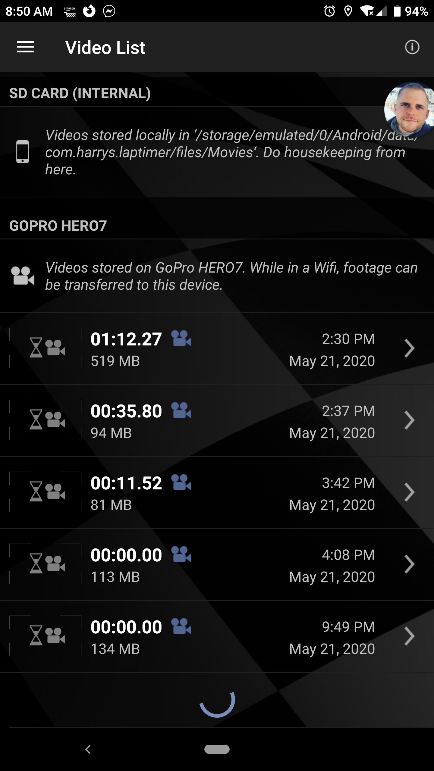

See title. Clock and GoPro hero 7 silver have same clock time, and show the same until the external video is migrated to device, whereupon it is 5 hours too early.
I can't seem to find a way to fix this.

This was a manually recorded test lap, so I don't have the option described in the video. Unless I'm supposed to remove the link and relink it, overriding the sync stamps that were automatically created by HLT.
Adjusting the sync end point does nothing except make the overall time. sync worse.
Edit, tried both to no avail. Again, this seems to be an HLT download issue - the time is displayed properly in HLT when viewing the video under "external" in the app prior to migrating it (via HLT auto download), whereupon the download decides to subtract 5 hours from the timestamp for no apparent reason. It gets the minute stamp right...
