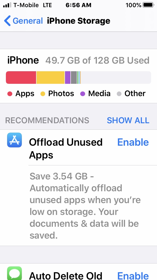

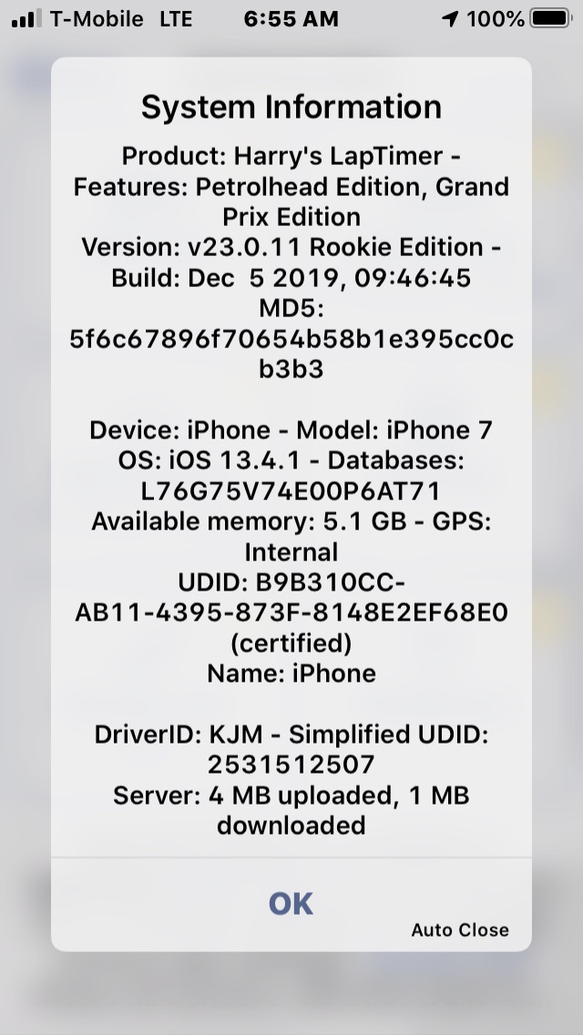

Re: iOS: Overlay export not enough space
Posted: Thu Jun 04, 2020 1:29 pm
by GreatUK
Harry, here are the screen shots you requested...
Posted: Thu Jun 04, 2020 3:46 pm
O.k., so it looks like this is the problem. It is not possible to disable the memory check in LapTimer currently. So we need to find a way to free up the cached data. LapTimer gets 5.1GB of free memory reported currently with 78GB actually free. Have you tried to reboot the phone?
