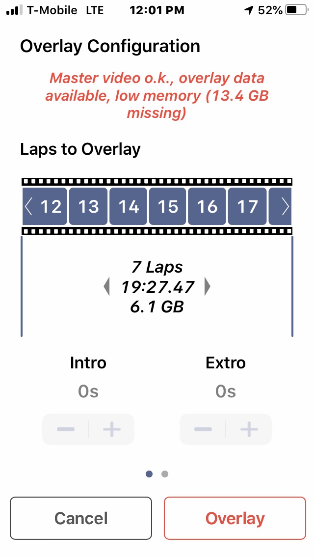

Do you overlay an individual lap or multiple laps? In case it is the later, please try a single lap.
When looking into the Overlay Configuration dialog (the one coming up when Video / Export is pressed), what do you see in size and duration? Or send a snapshot of this screen. And what resolution does the video have?

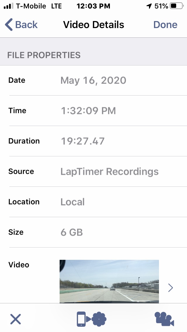

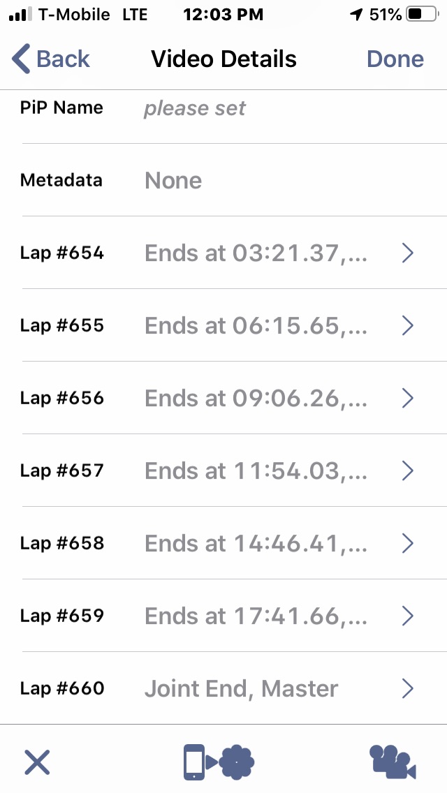

Thanks for the reply Harry. I am trying to overlay multiple laps. If I do one lap at a time, is there a way to edit the laps back together? Resolution is 4K UHD. Here are some screen shots...

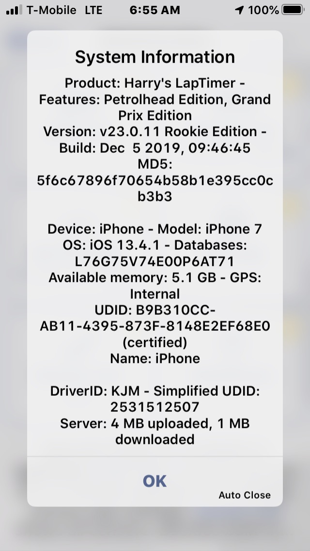

I just discovered a speciality in iOS which may cause this issue. LapTimer uses a system function to retrieve the memory available currently.
For my 11ProMax, it returns 133GB of free memory (see LapTimer ‣ Administration ‣ System ‣ Available memory). When looking into Settings app ‣ General ‣ iPhone Storage, I see 102 out of 256 GB are uses, so the memory available is 153GB. So in this example, there is a difference of 20GB.
Developer forums say this gap is memory used currently, but freed up by iOS in case it is required. So this is typically cache data to improve performance. LapTimer uses the conservative value to check if memory will be fine for the overlay.
Before further investigating this, can you please check both values for your phone? Thanks.

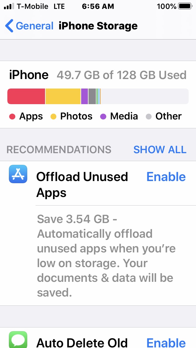

GreatUK
Posts: 6
Joined: Tue May 26, 2020 5:47 pm
Re: iOS: Overlay export not enough space
Post by GreatUK »
Harry, here are the screen shots you requested...
O.k., so it looks like this is the problem. It is not possible to disable the memory check in LapTimer currently. So we need to find a way to free up the cached data. LapTimer gets 5.1GB of free memory reported currently with 78GB actually free. Have you tried to reboot the phone?
