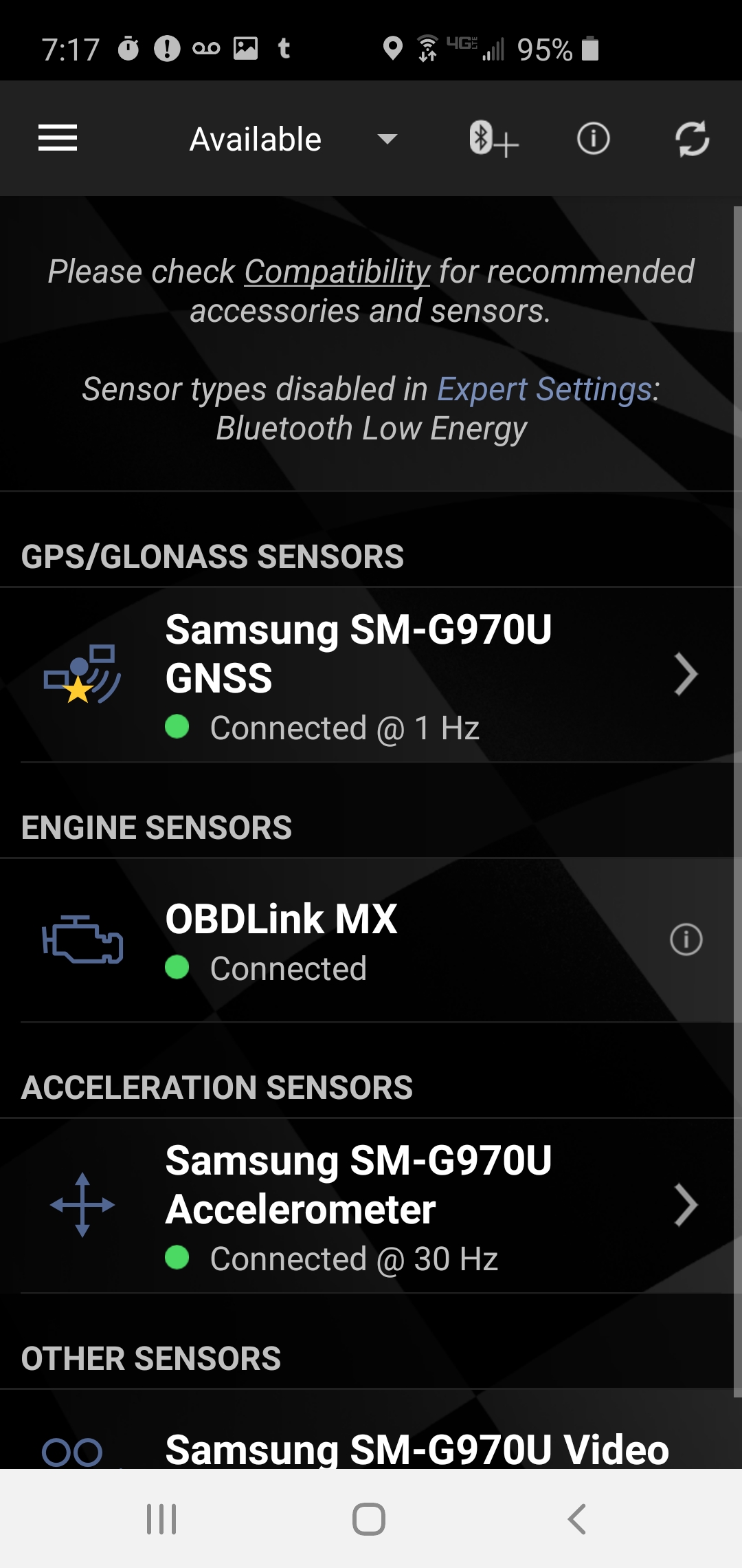

I have the OBD link MX on a 2002 Corvette Z06. It seems to work with Lap Timer on occasion but not regularly. As you can see from the screen shot it looks to be connected but it does not provide any data. I have had it provide data in the past but it wont show everything I think it should. For example it has never shown gear position.Am I doing something wrong here? Thanks in advance for the help.

Please goto LapTimer ‣ Administration ‣ Sensors ‣ OBD Link MX ‣ Info with your smartphone connected and engine running. Create a snapshot of the Sensor Information you will see and post it here. Thx.

here are the screenshots you requested.

In case your engine has been running when creating the screen shot, there is no communication between MX and your car established. In this case, please start with the „OBD Troubleshooting“ FAQ here on the forum.

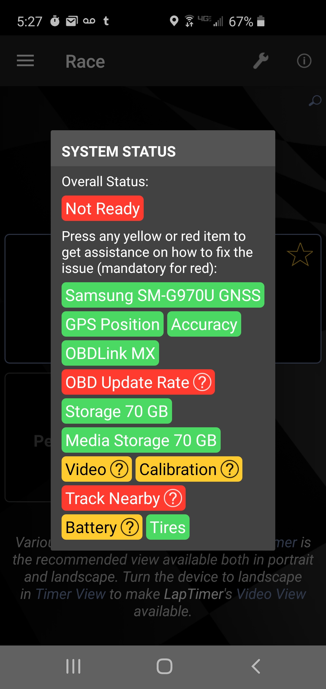

I went to the FAQ and Changed the broadcast request from ALL to ECU, and also moved adaptive timing from Optimized to Enabled. Then i backed out to the the look at the sensors and it said the OBS sensor was connected. I then backed out and went to the Race screen. The screen showed "ready" when I first was there but went to "not ready" in about 2 seconds. I got this screenshot from the sensor page
Re: OBD update rate?
Have you made sure no other OBD app is active in background? Reboot the phone to be sure. If yes, you need to proceed with creating a log file as described in the FAQ.
