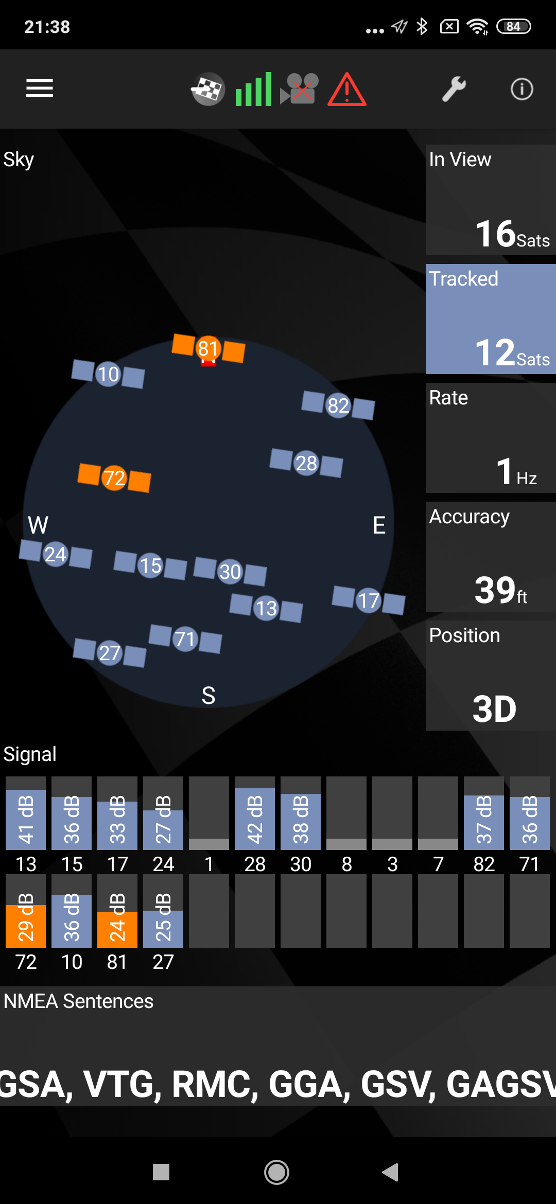

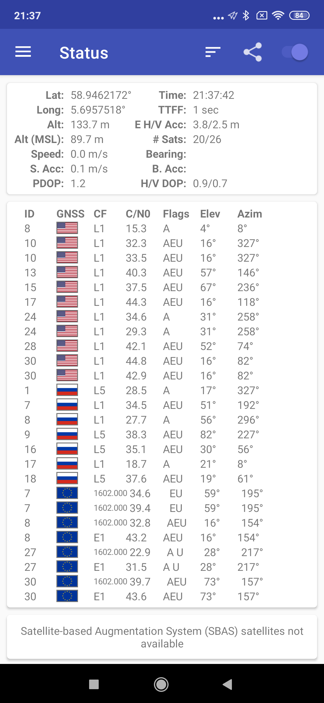

Just tried using laptimer with my new phone, which features high precision Dual Frequency GNSS.
It tracks both E1/E5 Galileo, L1/L5 GPS, plus GLONASS and Beidou at the same time, for increased satellites and improved performance.
When using a GPStester, it shows i am seeing 20/26 satellites, whereas using laptimer i am only seeing 12/16. Precision is 3.8m vs ~12m (39ft).

- Screenshot_2019-10-18-21-38-40-901_com.harrys.laptimer.png (311.16 KiB) Viewed 5452 times
- Screenshot_2019-10-18-21-37-42-624_com.android.gpstest.png (276.4 KiB) Viewed 5452 times

LapTimer ignores Galileo satellite information (GAGSV) currently. In case you want support, please create a log file with GPS/GLONASS Sensors traced and send it to me. Make sure you are outside when logging.

Thanks for sending the log file. I discovered several items and fixed them for LapTimer v23.0.9:
1) GPS/Galileo/GLONASS satellite ids were delivered as local IDs and overlapped in parts (see your snapshot). This made LapTimer overwrite and drop satellites. v23.0.9 will map local IDs / PRNs to a global NMEA ID before doing any further processing. As an example, the Galileo #8 satellite will show up with id #308 and the GLONASS #8 satellite will show up as
2) Your device uses a u-blox 9 chipset using some non-standard NMEA extensions. v23.0.9 will cope with both the Standard and u-blox 9 specific extensions.
3) Your device delivers NMEA sentences GAGSV, GLGSV, GNGGA, GNGSA, GNRMC, GNVTG, GPDTM, GPGSV. All but the VTG and DTM sentences are used by LapTimer. VTG is redundant to other sentences and DTM is not required (local time information). For your reference, a good overview in NMEA sentences is available here: https://gpsd.gitlab.io/gpsd/NMEA.html
4) Finally, I found a bug that occurred for satellite IDs starting with a '0' digit.
