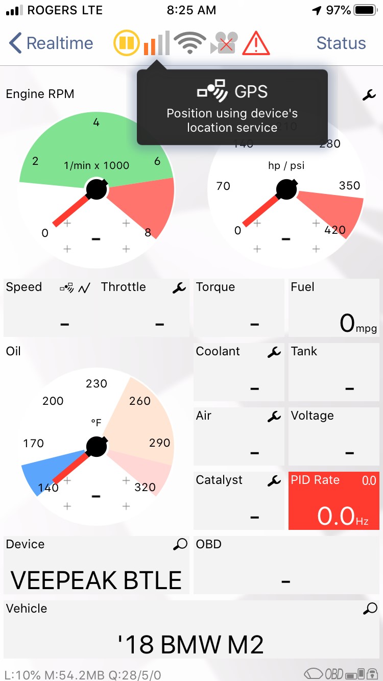

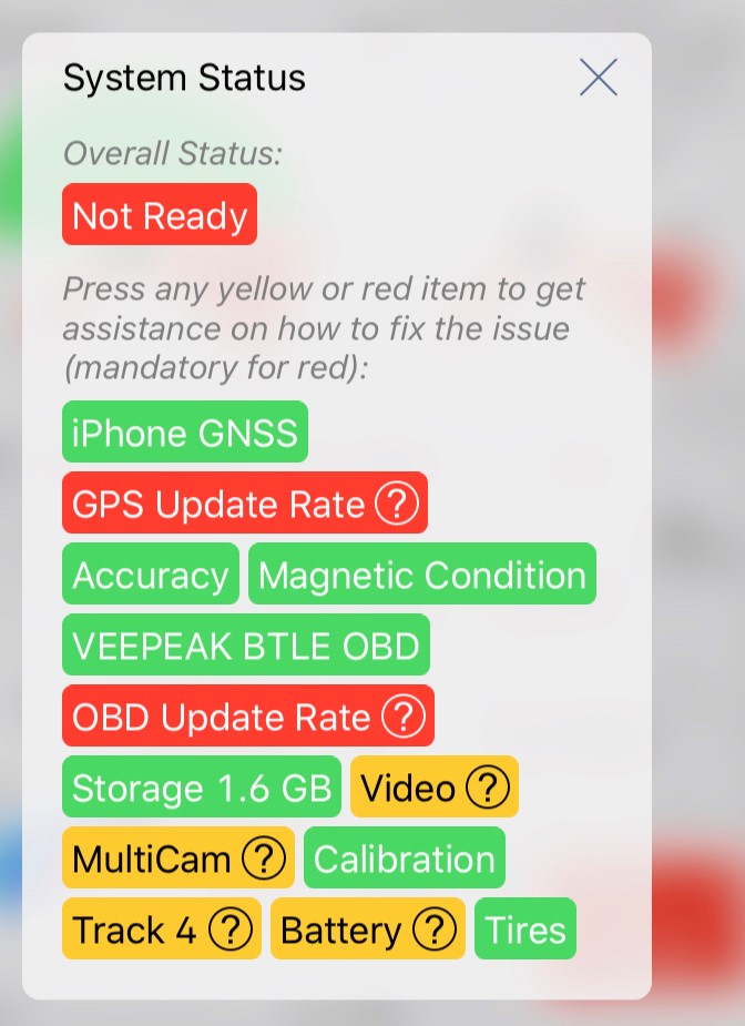

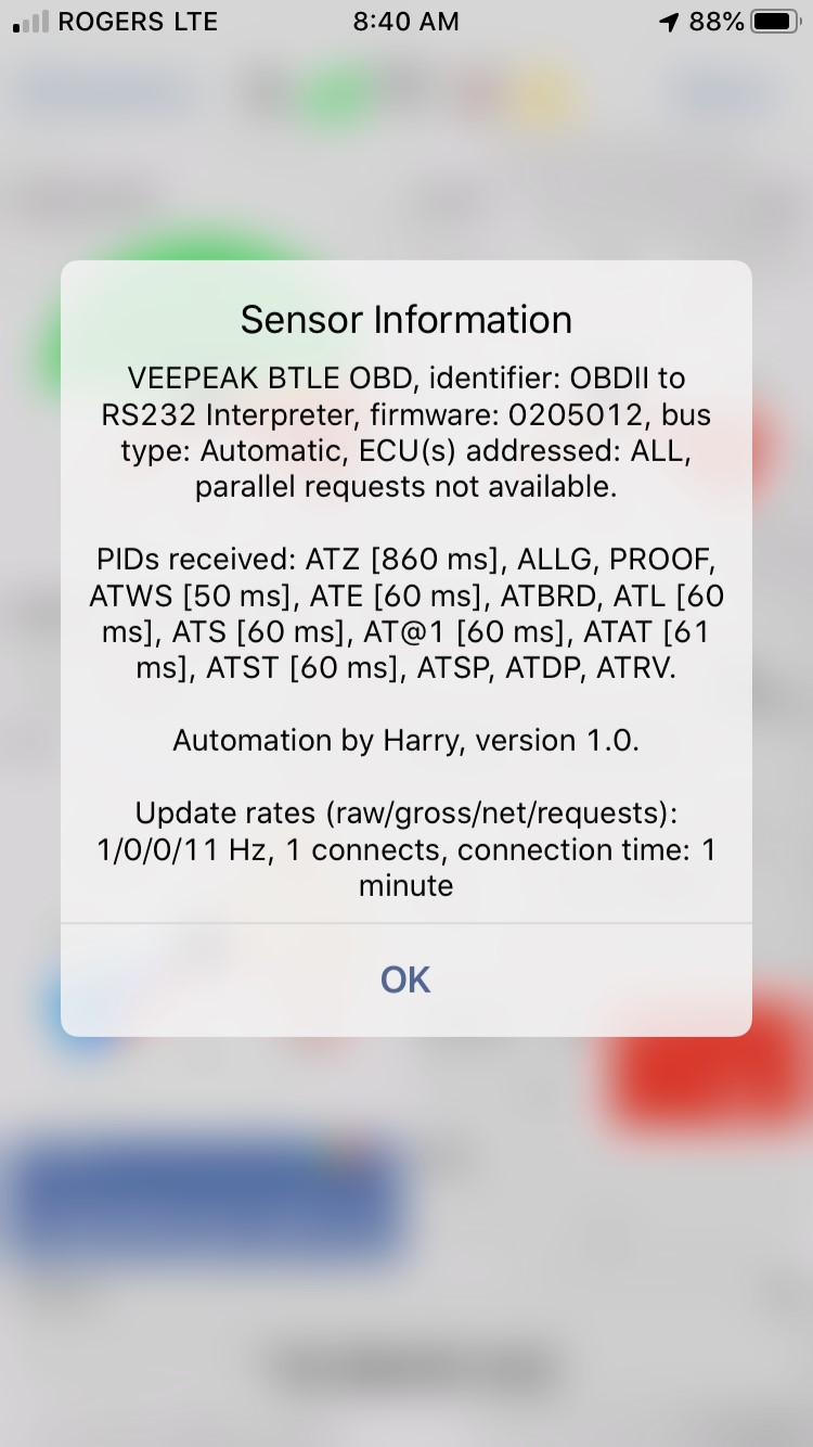

hi Harry i am having similar issues with my 2018 BMW M2. the Veepeak connects but does not display any data and the dongle works just fine with the BimmerCode app. i also restarted the phone to make sure the bimmercode app wasnt interfering and followed the steps in the FAQ but to no avail.
i have the grand prix edition.
can you please advise.

What I see in Sensor Information is That the adapter fails to negotiate the bus protocol with your car. You can try selecting your car’s protocol in LapTimer’s Expert Setting / OBD Tweaks. Try the CAN 11/500 protocol, it is the one used mostly.

Yes that worked! Had tried it by using another app to see the protocol and once I chose that all good.
Thanks for the response! Looking fwd to test on track this Monday
