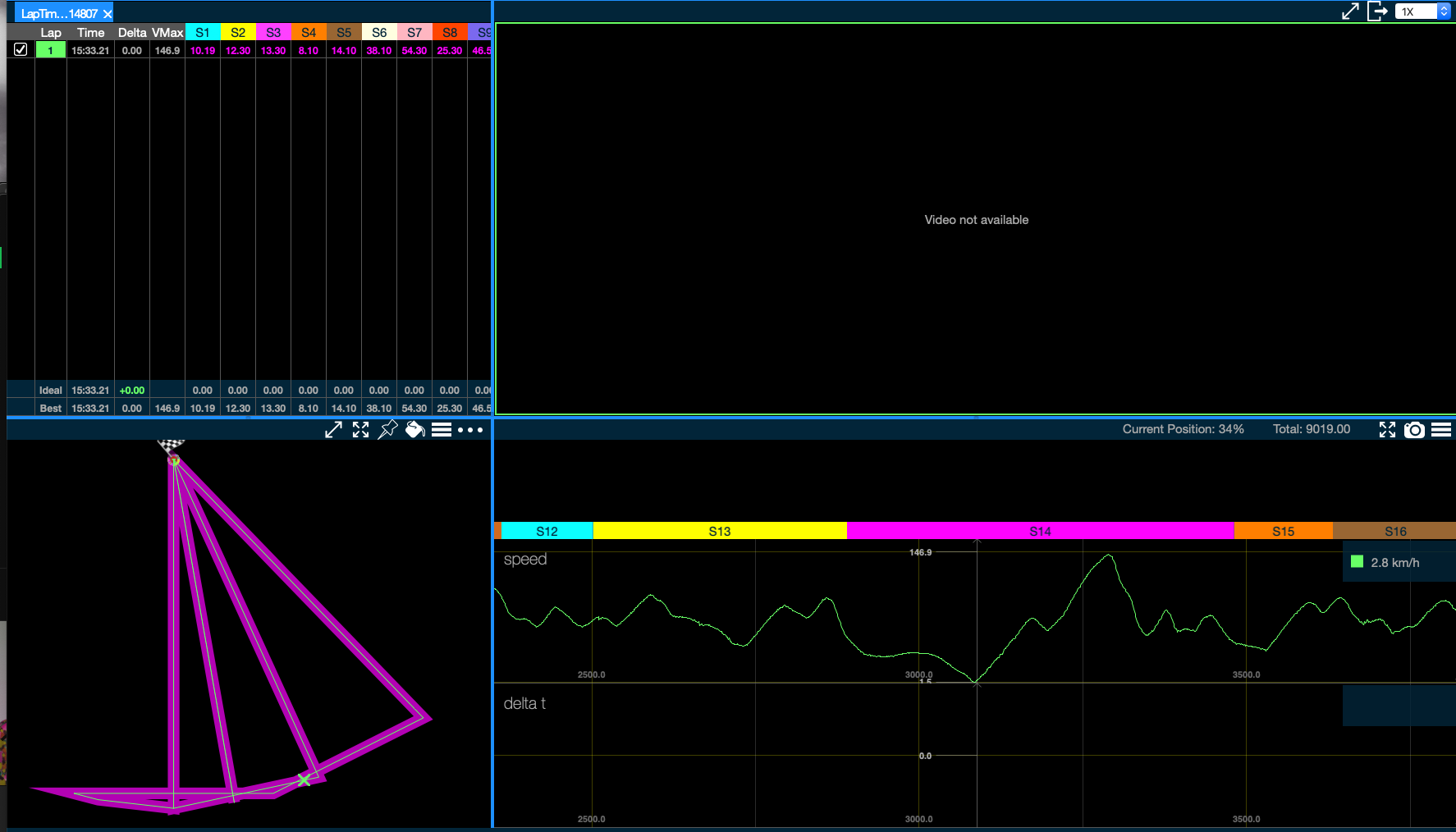

The lap of 8/11

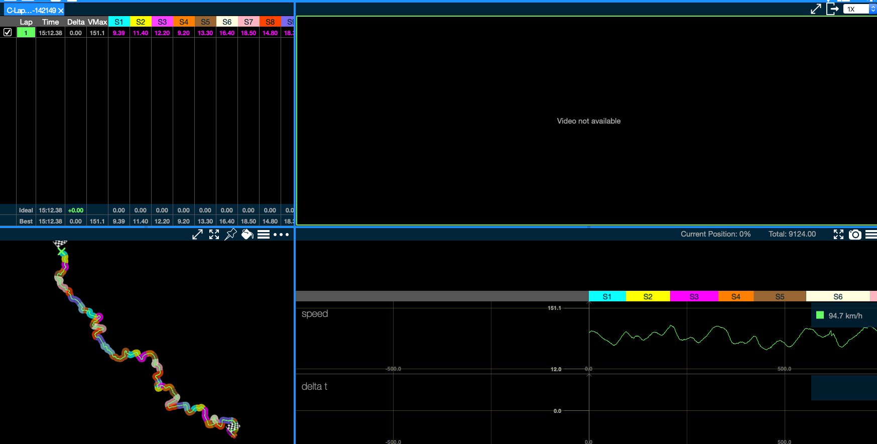

Same lap of 7/28 works fine.

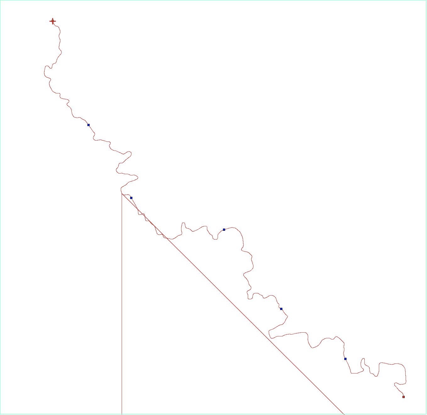

This looks like some interpolation problem. When zooming into the top point of the corrupted CT diagram, you will see something like this:
Screen Shot 2019-08-13 at 10.34.05.png (61.05 KiB) Viewed 7138 times
This means there are some rows included in the VBO which have wrong polar positions and add this long extends to the South. Using a shell command to look for coordinates out of range can look like this:

Remove these lines from the VBO using a text editor to get a proper display in CT. I have not tested it, but should work.
I will check what is going on for the next version.
