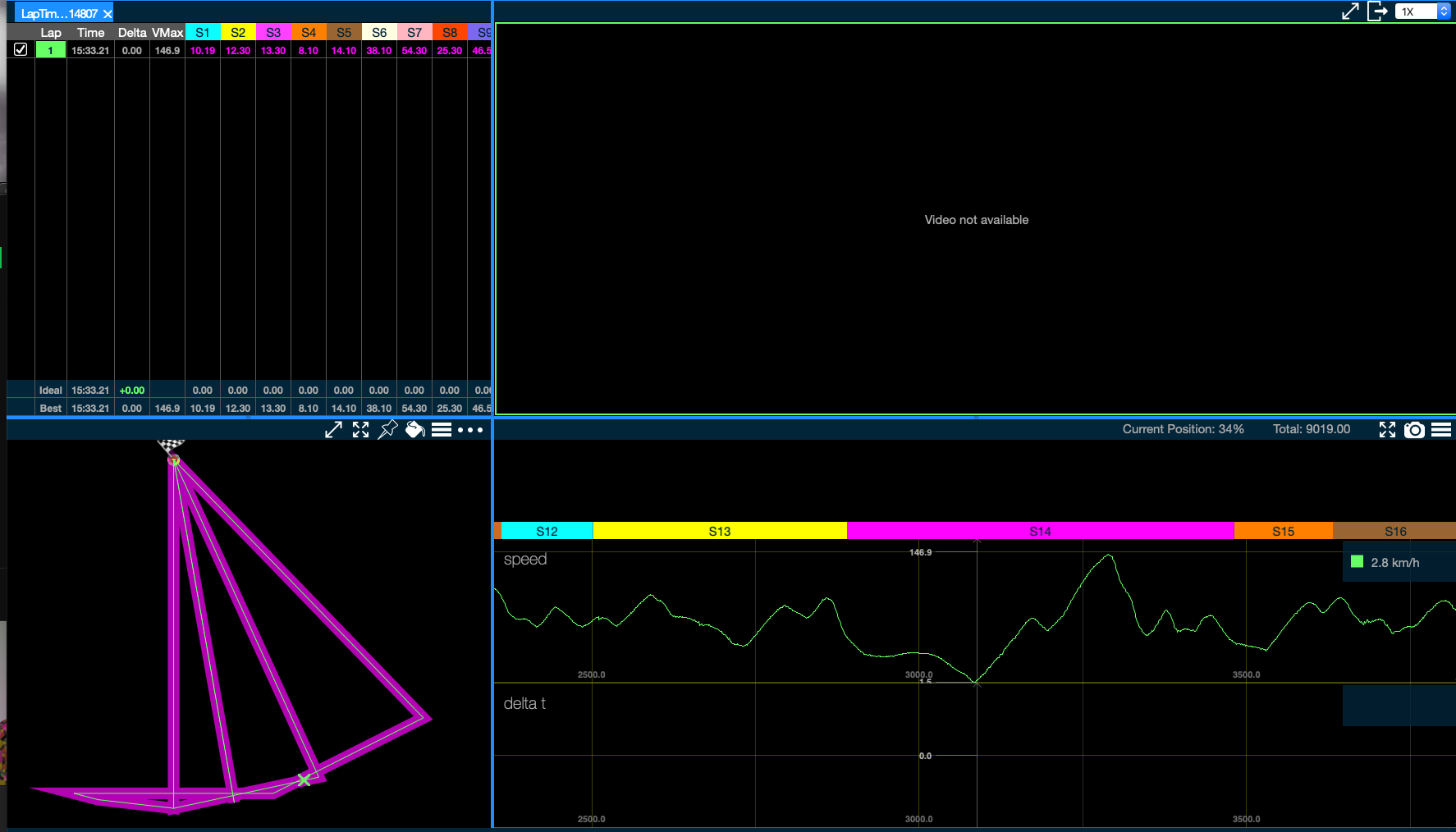

The lap of 8/11
Screen Shot 2019-08-12 at 1.53.47 PM.png (163.66 KiB) Viewed 7150 times

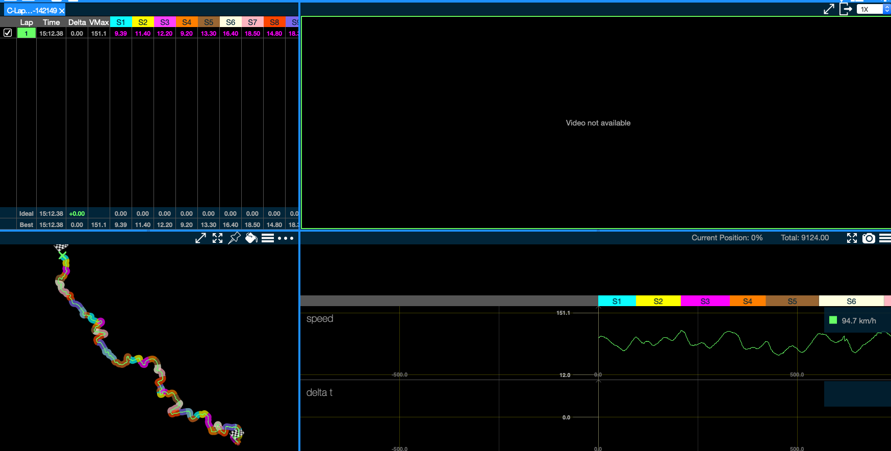

Same lap of 7/28 works fine.
Screen Shot 2019-08-12 at 1.55.30 PM.png (126.25 KiB) Viewed 7150 times

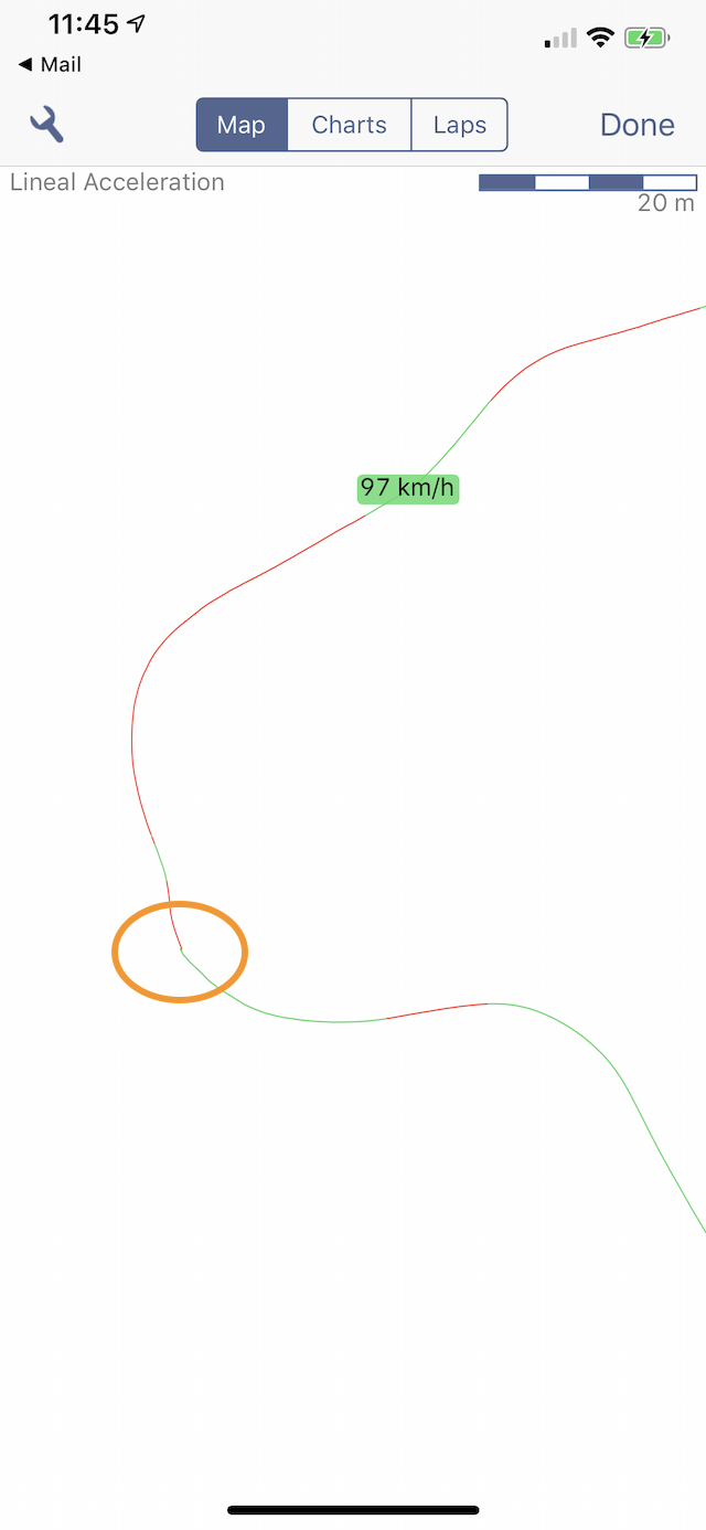

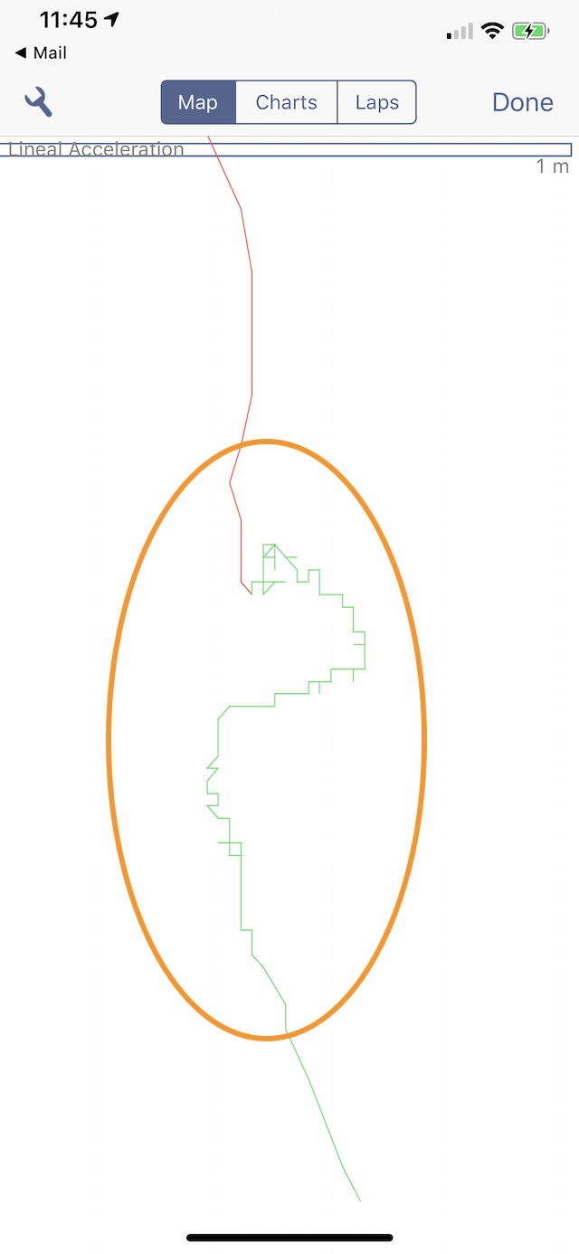

This looks like some interpolation problem. When zooming into the top point of the corrupted CT diagram, you will see something like this:
Screen Shot 2019-08-13 at 10.34.05.png (61.05 KiB) Viewed 7125 times
This means there are some rows included in the VBO which have wrong polar positions and add this long extends to the South. Using a shell command to look for coordinates out of range can look like this:
