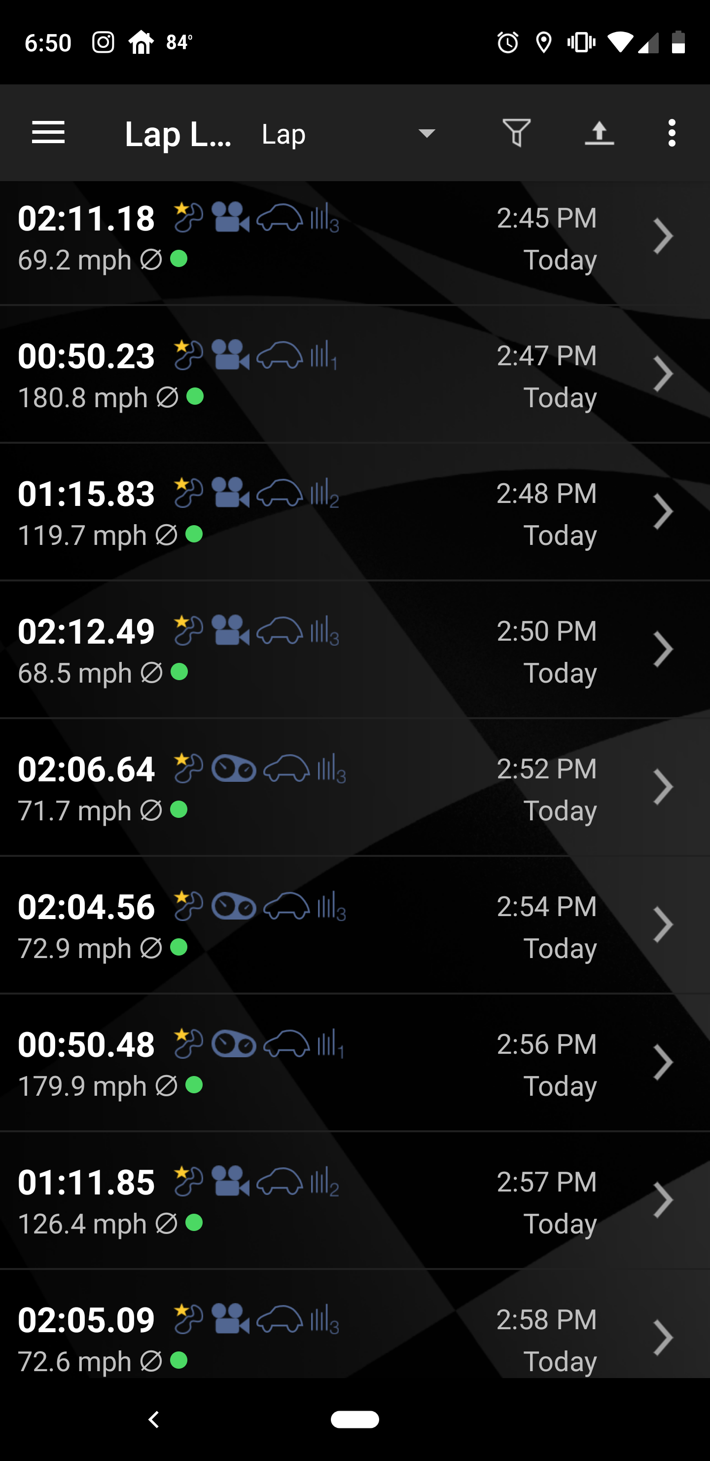

This is from Sonoma raceway.
Some laps get split it into two shorter laps. Is there a way to fix this?
Please see attached.
Re: Laps split in two
Select the second part of a lap you want to join (e.g. the 1:11.85). Select Fixes in the Data Recordings section. In the bottom of this screen, you will see a join button in case this part can be joined with the "lap" before.
Yes. The join operation is actually "join with previous". So you need to select the seconds "lap" to get the join function. In case it is not displayed for the second lap, this means its starting position does not match the first lap's end position. In this case, they cannot be joined automatically.
