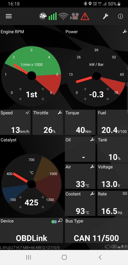

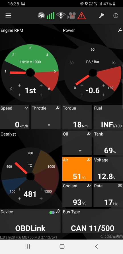

Hi, Harry
I´ve tested that settings for fuel and result is 50/50
At the first moment it showed 10% remaining, then it dropped to 9%, which I think was corresponding to reality.
Then I refueled to the max (i took 41 litres, max is 45).
After that, HLT shows "only" 69% of fuel tank. I checked vehicle profile and there is correct value for tank capacity.
Where should I look? What should I change?

Fuel Level
- after refuel
- 04.jpg (75.2 KiB) Viewed 2210 times
- before refuel
- 02.jpg (75.33 KiB) Viewed 2210 times

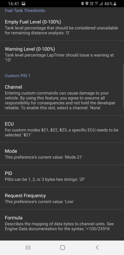

- PID settings
- 01.jpg (81.97 KiB) Viewed 2210 times

Fuel level is provided by OBD in percent. The value displayed is 1:1 what LapTimer receives. The levels in Expert Settings are uses for warnings and for remaining lap calculations. The tank size is optional and used to do any conversion between percentages delivered and volume values required in certain calculations.
So if you see 69% after filling the tank, this is what your car measures. Sometimes this value is low passed and take some minutes to give a better value.

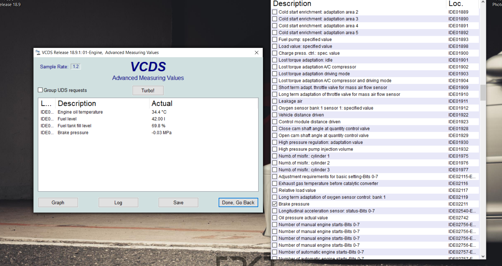

Re: Fuel Level
So, you were right. I´m testing it on my company car which is Skoda Fabia 3gen 1.0TSI (MQB platform), and that sh*t box really shows only 69% even on full fuel tank also in VCDS.
So
Settings for HLT are correct and ussable, tomorrow I´ll test it in my older Octavia II RS.
next step is oil temp
So
