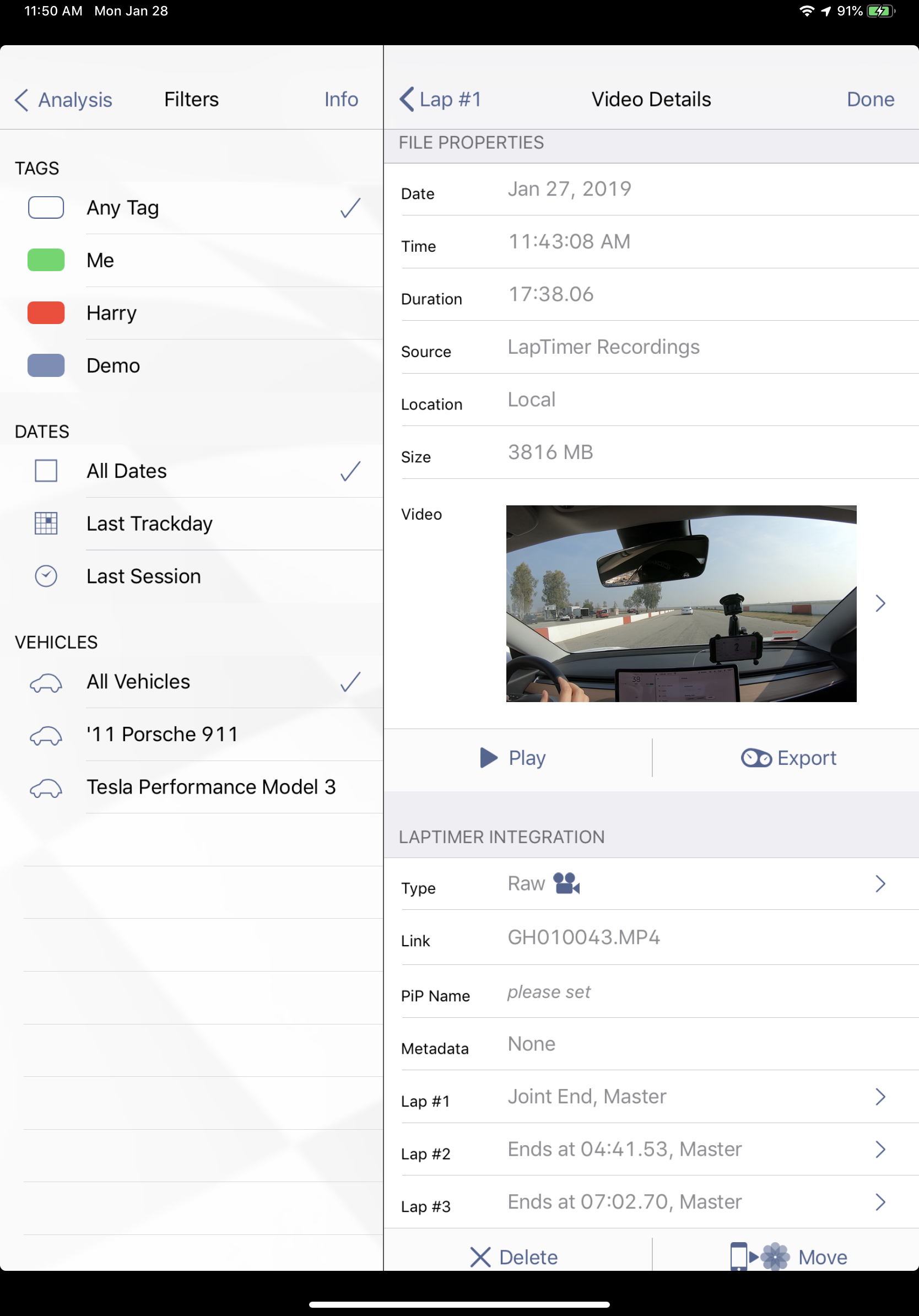

I imported a synced GoPro 7 video in iOS and when I go to export the overlay is not visible only the lap footage. This is with the overlay options checked. Preview shows the overlay fine. Exporting the built in phone video shows the overlay file. I tried on my iPhone Xs and iPad Pro.
Would love some help here.
Re: Overylay not exporting with GoPro 7 video
There is a problem with lap / video synchronization for your video. You can see that Lap #1's end matches the video's end (Joint End, Master) while the Lap #2's end is in front of it? This cannot be correct. To fix, select Lap #2 in the screen shown, in Overlay Synchronization, adjust the sync point using the blue arrow by one hundreds and press Set. LapTimer will ask you whether you want to apply this change to the full Session. Confirm YES. Verify the lap reference information is sound afterwards and try again.

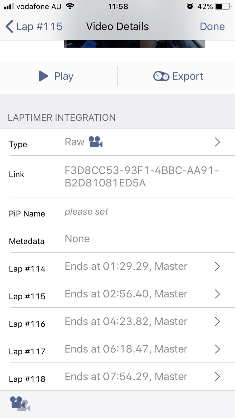

I am facing the same issue. On the video preview I can see the overlay, but after export the overlay to the phone camera roll, the overlay is not visible. So can someone help me on that?
See below some screen shots:

Here is the screen shot of the overlay on the app

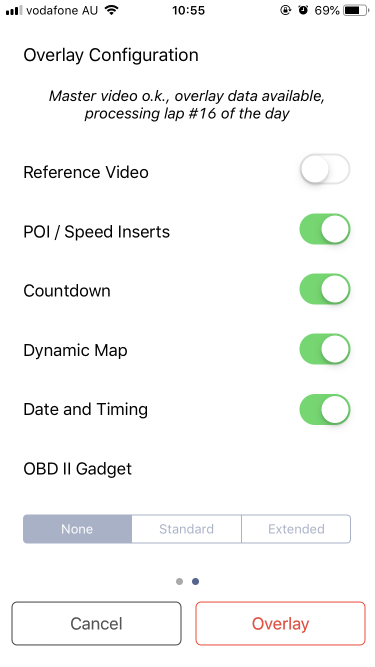

1) select a lap from Lap List
2) make sure it shows a valid track plot in the Data Recordings ‣ Preview row
3) make sure it shows a video thumbnail in the Video ‣ Preview row
4) in case it shows the video's type as "Overlaid", press the Revert or Original button shown below the video
5) press Export in the Video section now
6) create a snapshot of the Overlay Configuration screen you see now and post it here
7) press Overlay to export a new overlaid video
8) back in the lap details view, the type of video should have changed to "Overlaid" now with buttons "Play" and "Revert"/"Original" below
9) press "Play" and see if you get an overlaid video shown
Walk through this steps. In case anything happens that is not in line with the description, let me know. If anything doesn't work as described, let me know what exactly is different and what happens instead.

Hi Herry,
I did exactly what you said, but did not work. The type of video changed to “Overlaid” and with the buttons “Play” and “Revert”.
See below the screenshot from the overlay configuration:
What’s your thoughts?
Well, if you checked for all the items that they behaved / showed up precisely as described (except #9), I probably need to step through this items myself. To do this, export the single lap you selected in step #1 to .hlptrl and send it to Harry@gps-laptimer.de. In addition store the HERO7 video on some server space where I can download it (Dropbox sharing or similar). You can't use youtube, because your video will not be stored 1:1 here. It needs to be some file service.
