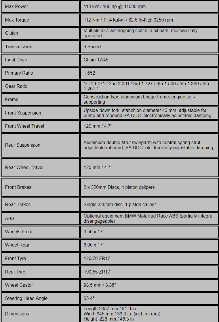

I can't find anywhere Drive ratio for my bike but can find Primary ratio (is it the same ?).

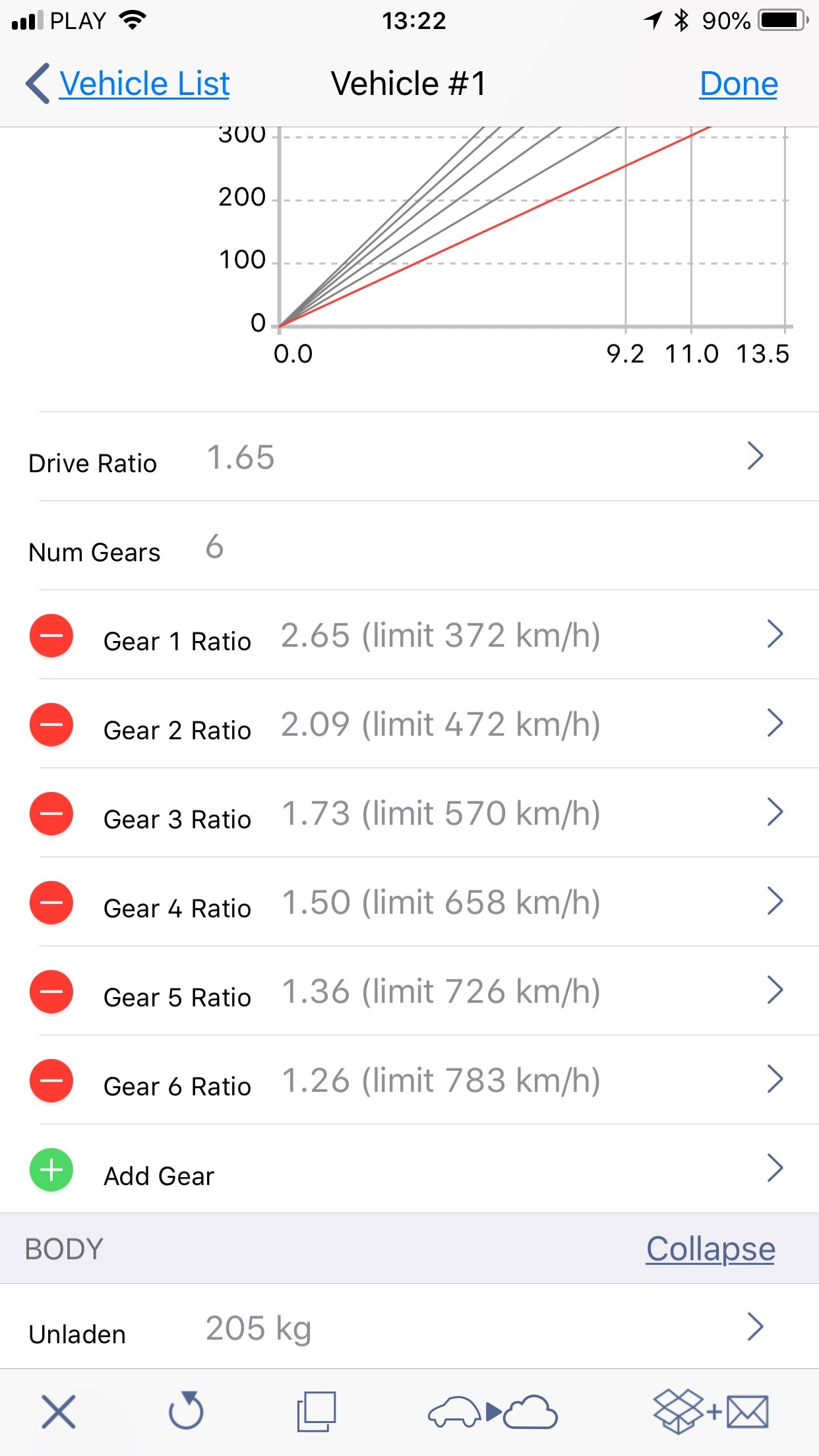

If I use this value provided by BMW for my bike 1.652 then calculation is completly wrong like on picture below:
And then indication of the gears on the screen is always 1st gear :)
When I set-up Drive ratio to 5.35 then i can see max speed on the gears correct but ger indication is wrong again and is showing me gear 2 on gear one etc.
Then when i set-up Drive ratio 4.45 max speed on the gears is incorrect but - gears indication is very close to work perfect (not on high RPM).

Gears and drive ratios multiplied need to be the inverse of engine and wheel revs. Or as a formula
  • engine rev = gear ratio * drive ratio * (rear) wheel rev
In case you need more help, it makes sense to post your precise moto model and what your read in the specs.

Re: Gears indication and Drive ratio
I‘d suggest 45/17*1.652, i.e. 4.37
In case this doesn’t work, please post any precise speed readout for a known gear and a known rpm value. This allows inverse calculation of the missing value.
