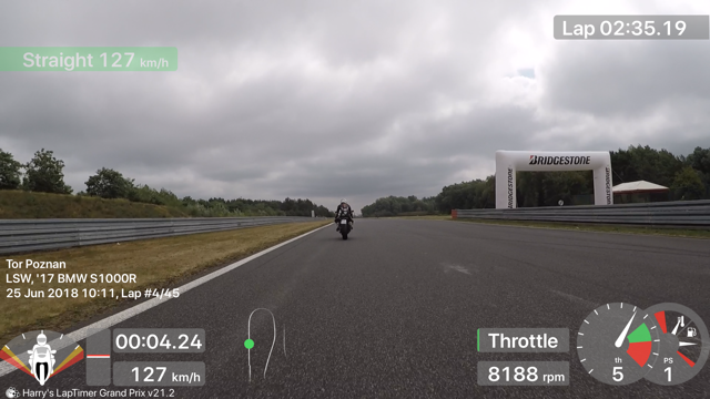

I have strange problem, which I have no idea how to sort it out.

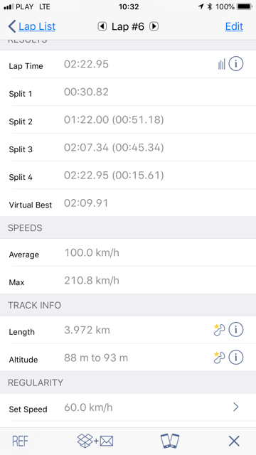

Maximum speed on the wideo is 127km/h where in real was 210km/h.

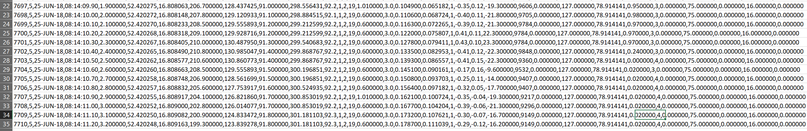

All is OK when speed is going up to 127km/h but when reach 127km/h - is not going up anymore. I have exported data to .cvs and there all is OK
Please see attached and help

Take care when discussing speed. LapTimer records both GPS and wheel speed in case an OBD adapter is connected. In the CSV file, you can see GPS speed is going beyond 127 while wheel speed is not. In case OBD data is available, LapTimer will use wheel speed for displays. To get GPS speed instead, turn off OBD gauges in Overlay Configuration during Video Export.
The reason wheel speed is not going up is probably due to some freeze in OBD data flow. This can happen in case the adapter loses connection to the smartphone. There are other reasons too.
