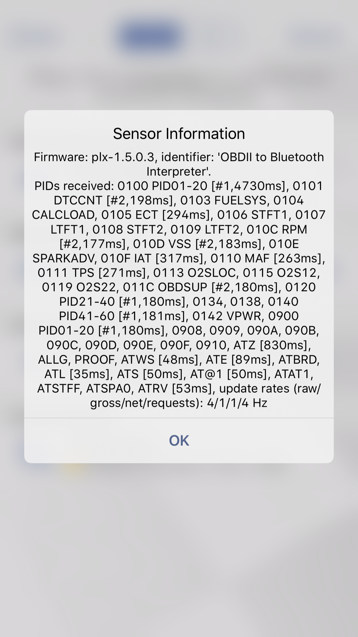

Still couldn’t get it to work. Ive attached the sensor info below but cant get any of the throttle, temps etc.

Oops sorry. Also trottle positiona shows on my professional bmw scanner in real time so i know it works.

It looks like your car does not pass any standard throttle PID (0x11, 0x47, 0x48, 0x49, 0x4a, 0x4b)... That's actually the first car like this I have ever seen. Please double check you have not excluded the PID in OBD Tweaks, but most probably, you are out of luck currently.
Whether a proprietary BMW tools displays throttle or not, is not relevant for standard OBD II operation. You may be aware many cars display oil temperature in the dashboard, but do not deliver it using the standard OBD II PID. Throttle is certainly available on your car's bus, but the manufacturer decided to not map it correctly.
You may try to find out the custom PID BMW uses for throttle. LapTimer v22 will allow you to add this manufacturer specific codes.
