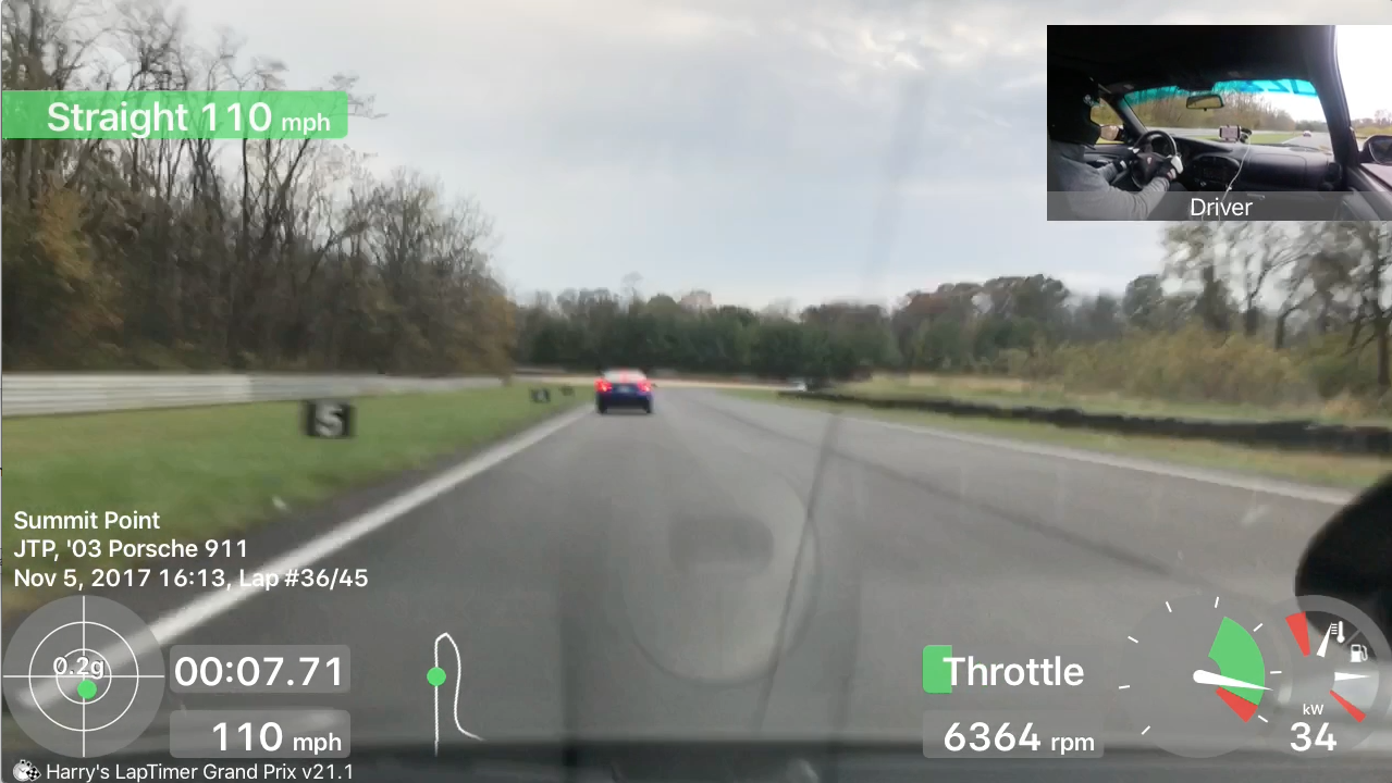

My exports with overlay before the iphone stopped recording are fine, are exported at 1280x720 and include the gopro footage as a picture in picture (PIP). See lap 36 attached.

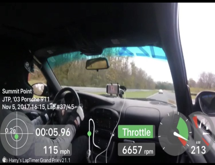

But when I export laps with overlay after the iphone stopped are being exported at 640x480. See lap 37 attached. I can convert them to 853x480 to correct the aspect ratio, but I'm really hoping to export at full resolution.
Does anybody know how i might be able to do this?
Lap 37 - gopro footage 640x480

Lap 36 - iPhone footage 1280x720 including PiP
720p with pip.png (882.09 KiB) Viewed 2212 times

LapTimer (iOS) may generate videos with wrong aspect ratio for not supported width/height resolution combinations, but never change the resolution. Can you please check if you have transferred the correct video from your GoPro? GoPros record videos at several resolutions, at least the full size video plus a thumbnail version.
