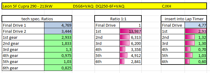

Hi Harry, I would like to bring alive this topic. I´m trying to calculate drive ratios for 6 (7) speed DSG which have 2 final drives.
Problem is this: if I calculare everything to 1:1, then 5th gear is higher than 4th and 6th and app can´t handle this. Yes, I´ve tried your HOW-TO as you mentioned above. But I can´t use it, because you calculate with gear sets 1-2-4-5-R and 3-6-7 for AMG trans. But VW DSG have sets 1-3-5-7 and 2-4-6 (R is not relevant for this case). Can I ask for some advice how to solve its?
I have these ratios:

Hi, I updated my recent post with sheet, where you can see the difference
2016 SEAT Leon CUPRA 290 ST

Yes, but the 1:1 values do not match the 1/2 gear sample? Why not?

Re: Converting gear ratio to compatible value for Laptimer
math is correct, all numbers in my table in 1:1 ratio are correct. As I mentioned I have to calculate FD1 = 1-3-5 gears, FD2 = 2-4-6 gears.
Yes, if I try to use your sample with 1-2-4-5-R and 3-6-7 for AMG trans then yes, it will be good but it does not agree with the actual sorting of gears in the transmission on their FDs. Or should I just ignore it and calculate it with your sample of gear sets?
Please recheck the final drive mapping of the gears. The multiplication from gear ratio and final drive represents the ratio between engine rpm and wheel rotations. So when applying this for all gears, the number needs to go down from high to low and for 1 to higher gears. This is independent from LapTimer, it is mechanics.
