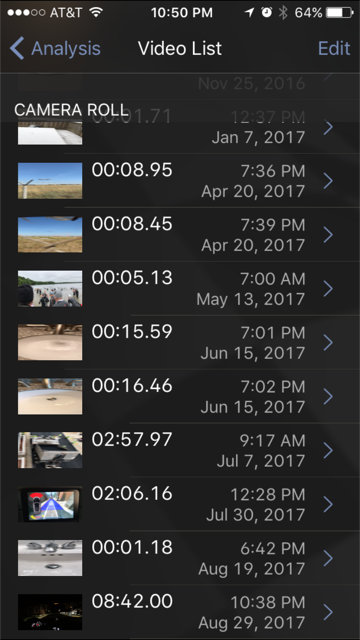

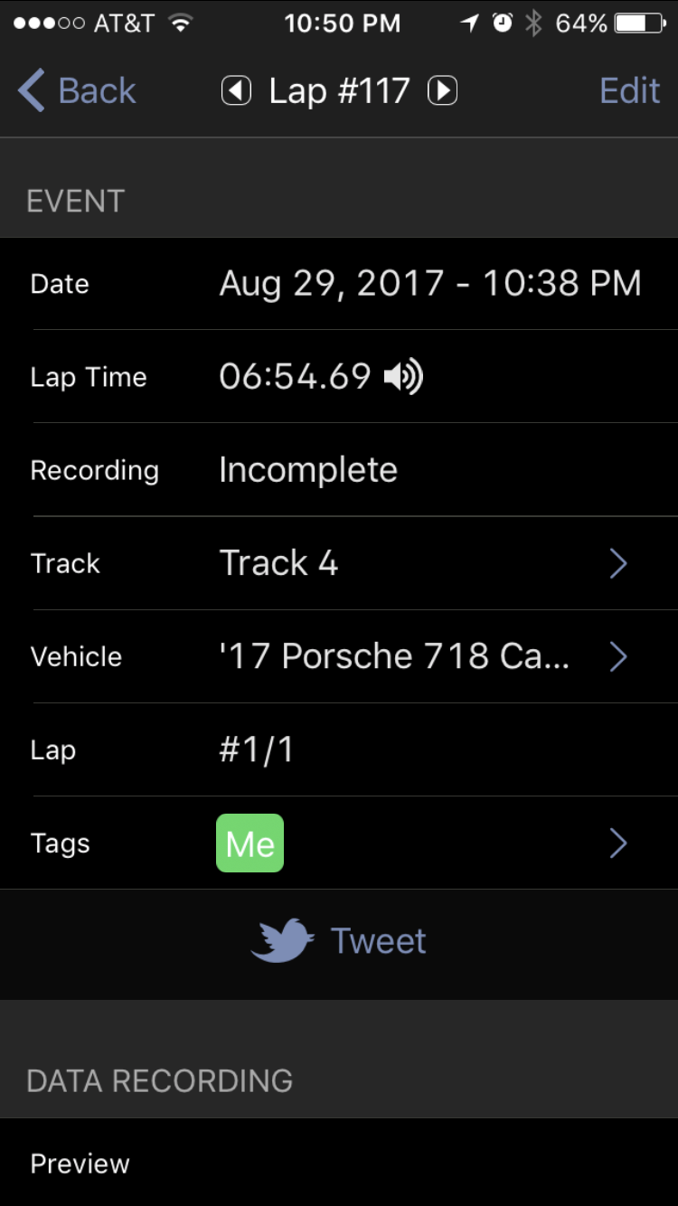

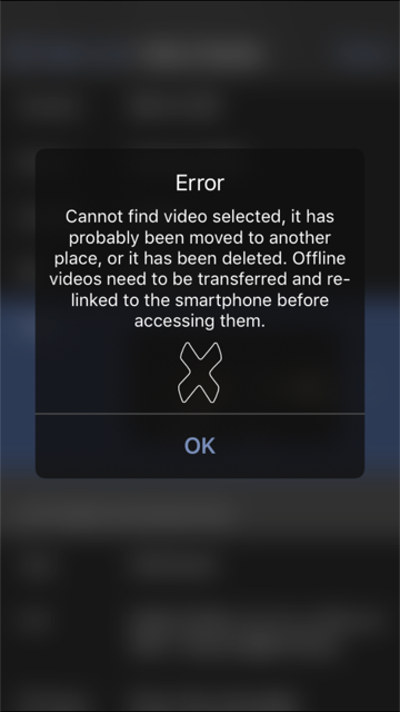

I recently tried to take a video with overlay for the first time. I did it during a loop starting and ending at my home, using a made up "track". When I finished, the video showed up in the lap data but it gave me some kind of error message about it having to be exported and resynched or something like that. Unfortunately I didn't take a screen shot. When I viewed it in the videos list sandbox section, I got the same message. So I tried copying it to my camera roll. Now, I can play the video from the camera roll but can't find any way to get it back into to Harry's for overlay integration. Here are some screen shots of what it looks like now. I don't know if any of it is related to the lap being listed as "incomplete." I had two other screen shots but I couldn't get them small enough to be accepted for upload.

The message you received is that some laps covered by one video recording cannot be overlaid as a multi lap video. Please consider this a warning that may occur if either some laps have been deleted (creating kind of a missing section in a session), when sync points have been adjusted manually, or for certain track configuration. As written before, you can usually ignore this (and I tend to remove the message completely for some future release).
In case a video associated by a lap recording is moved around manually, LapTimer cannot access the video any more and the named message will appear. To fix that again, select the lap and touch the row in Video section showing the OFFLINE Preview. Select Re-Link in the video details dialog appearing and select the video again.
