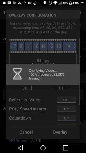

Exporting a complete session - about 18 mins. When Overlaying Video the app gets to 100% (32575 frames) and the app locks up. Have to kill app and restart. Sometimes it locks up at lower percentage completed - but I can usually restart and it completes. This particular session I am zero for 3.
Here is a screen shot.
